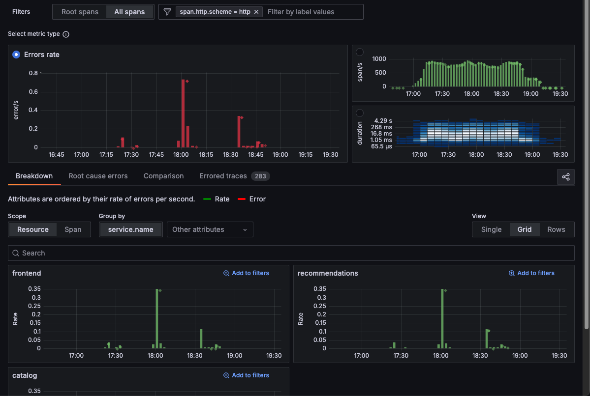

Use the Breakdown tab
The Breakdown tab splits the selected metric by the values of a chosen resource or span attribute. When you’re using Duration metrics, Breakdown shows the 90th percentile duration for every value of the selected attribute orders the sequence of attributes by their average duration. When you select Rate, Breakdown orders the sequence of attributes by their rate of requests per second, with errors colored red.
You can change the Scope to show Resource or Span.
Using the Group by selector, you can group the selected metric by different attributes. For example, if you have selected Errors as a metric type and then choose the service.name attribute, the displayed results show the number of errors sorted by the service.name with the most matches.
Errors metric showing the Breakdown tab without filters
The app defaults to service.name and displays other commonly used resource level attributes such as cluster, environment, and namespace. In the drop-down list, you can choose any resource level attribute to group by.

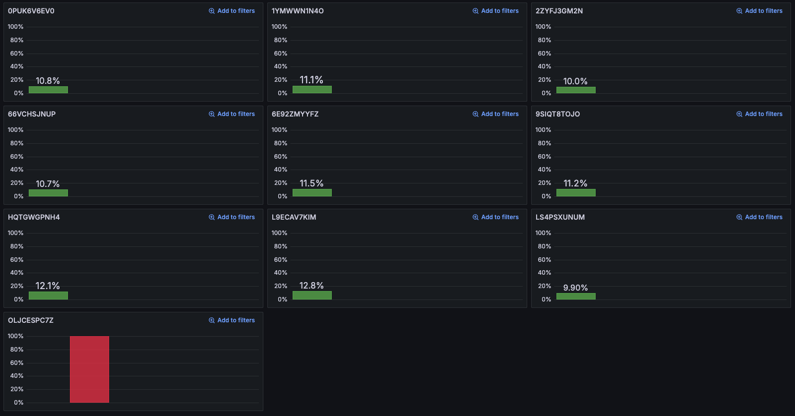

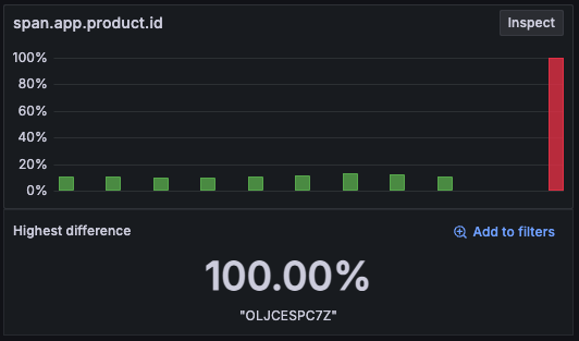

Focus on individual attributes with Inspect
Inspect lets you breakdown and see the individual attribute values from a given comparison If you have a comparison like this, you can highlight the value with the highest difference (here, attribute=value is span.app.product.id=OLJCESPC7Z ), but you can’t easily see all other values.
Select Inspect on an attribute
When selecting Inspect, the app shows only one attribute, span.app.product.id, but with a visualization for every value.
Inspect focuses the results on the selected attribute

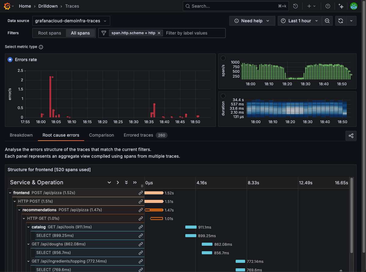

Use the Structure tab

  • Errors provides Root cause errors

For Errors, the Root cause errors tab shows the structure of errors beneath your selected filters. Use this tab to immediately see the chain of errors that are causing issues higher up in traces.
Link to span data from Root cause errors
