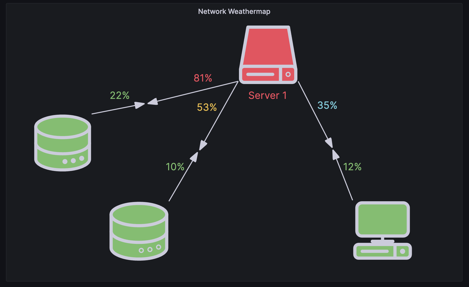

Canvases combine the power of Grafana with the flexibility of custom elements. They are extensible visualizations that allow you to add and arrange elements wherever you want within unstructured static and dynamic layouts. This lets you design custom visualizations and overlay data in ways that aren’t possible with standard Grafana visualizations, all within the Grafana UI.
If you’ve used popular UI and web design tools, then designing canvases will feel very familiar. With all of these dynamic elements, there’s almost no limit to what a canvas can display.

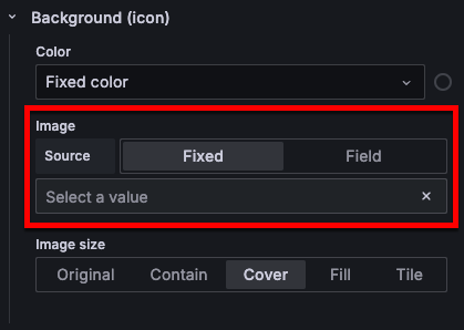

  6. (Optional) Add a background image to your icon with the Background (icon) option by following the steps to add a custom image.
If you don’t have an SVG file, you can use a rectangle element instead of an icon and set its background image to an image file type. To add a custom image for another element type, follow the steps to add a custom image.

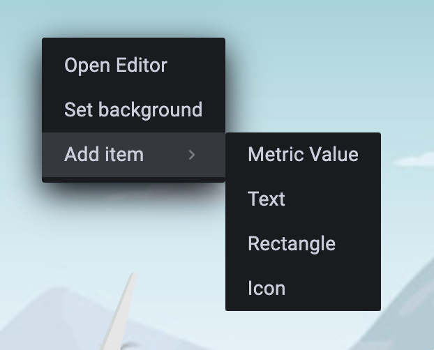

Context menu
The context menu lets you perform common tasks quickly and efficiently. Supported functionality includes opening and closing the inline editor, duplicating an element, deleting an element, and more.
The context menu is triggered by a right click action over the panel or over a given canvas element. When right clicking the panel, you are able to set a background image and easily add elements to the canvas.

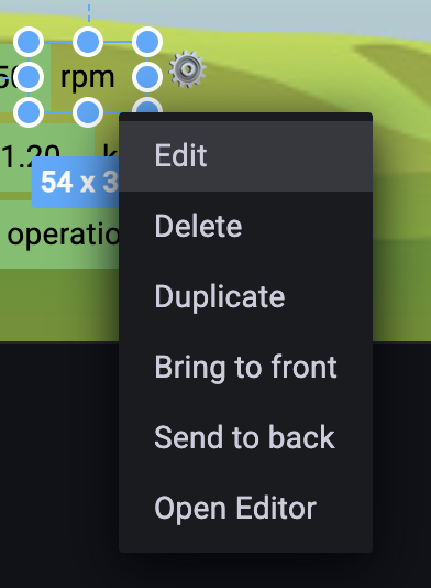

When right clicking an element, you are able to edit, delete, duplicate, and modify the element’s layer positioning.
