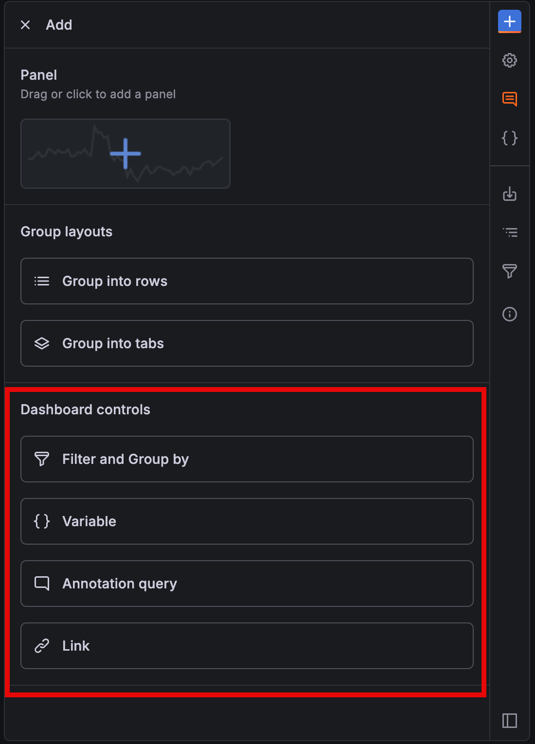

Dashboard controls
In the Dashboard controls section of the sidebar, you can add variables, annotation queries, and dashboard links without leaving the dashboard.

Add annotation queries
To add an annotation query, follow these steps:
  1. Navigate to the dashboard you want to update.
  2. Click Edit.
  3. Click the Add new element icon (blue plus sign).
  4. Click Annotation query.

To add a link to another dashboard at the top of your current dashboard, follow these steps:
  2. Click Edit.
  4. Click Link.

Add a link to a URL at the top of your current dashboard. You can link to any available URL, including dashboards, panels, or external sites. You can even control the time range to ensure the user is zoomed in on the right data in Grafana.
To add a URL link to your dashboard, follow these steps:
  2. Click Edit.
  4. Click Link.

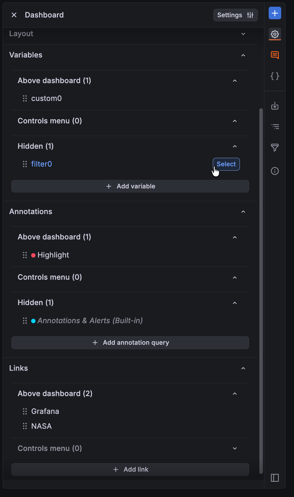

Manage dashboard controls
After you add dashboard controls, you can manage them from the dashboard options. The sidebar includes collapsible sections for variables, annotations, and links, including hidden controls that aren’t otherwise visible on the dashboard:
To manage dashboard controls, follow these steps:
  1. Click the Dashboard options icon in the sidebar.
  2. In the sidebar, expand the appropriate collapsible section.
  3. Do one or more of the following:
    • Edit: Click Select on the control to open the sidebar so you can make updates.
    • Reorder: Drag and drop controls to reorder them.
    • Change display: Drag and drop controls between sub-sections Above dashboard, Controls menu, and Hidden to update the control display option. Note that links can’t be hidden.
    Tip
    To get back to controls management from configuration, click the Dashboard options icon.
  4. Make any other changes as needed.
  5. Click Save.
  6. (Optional) Enter a description of the changes you’ve made.
  7. Click Save.
  8. Click Exit edit.
