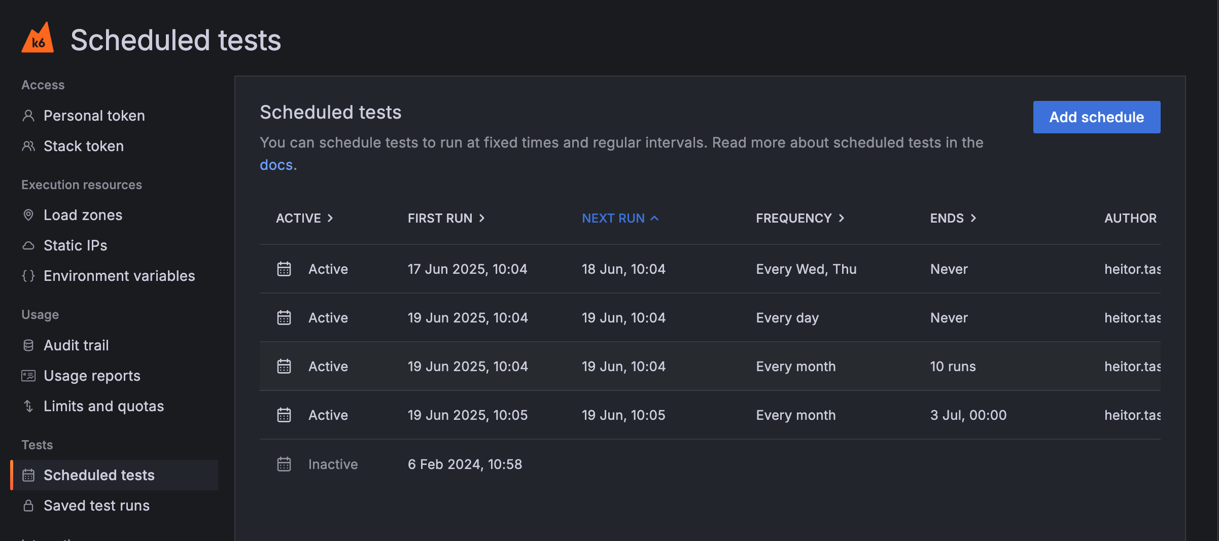

Manage scheduled tests
To view and manage all the schedules for your stack:
  1. Log in to your Grafana Cloud account.
  2. Go to Testing & synthetics > Performance > Settings.
  3. Under Tests, click Scheduled tests.
In this page you can view, edit, and delete any scheduled tests, as well as add new scheduled tests.
Test schedules table in Grafana Cloud k6, showing active and inactive schedules.
