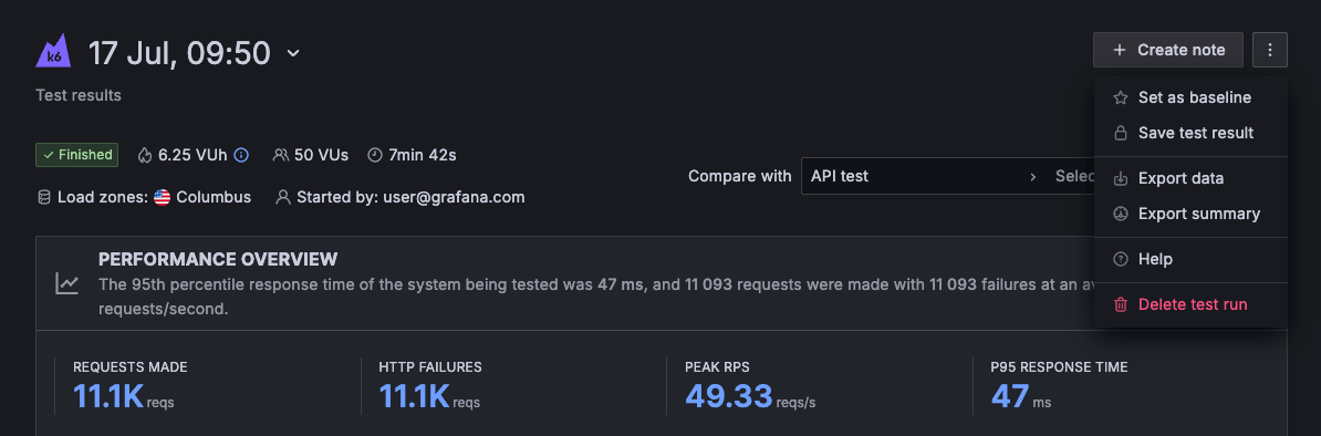

To do any of these actions, use the vertical-dots icon to open the Test Result menu.
Test Results Menu

To save a test run, follow these steps:
  1. Use the three-dot icon in the top-right corner of your test run.
  2. Select Save test result.

To create a note, follow these steps:
  2. Select Create note.
The Create Note option launches a modal window with a text box. You can then write comments about the test, mark changes, or add any context worth noting.

To delete a test run, follow these steps:
  2. Select Delete test run.
  3. Select Delete test run on the dialog box to confirm.
