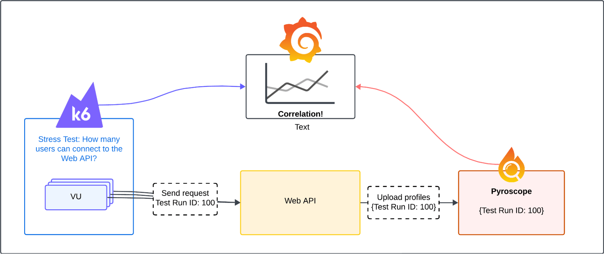

To illustrate an example of how this feature can be leveraged, consider a web server that serves a REST API over HTTP. The service must support a throughput of 10k requests per second. To test this, a k6 load test is written to find the upper bound of the RPS throughput. After the test is run, it is observed the throughput of the service is only 4k requests per second. The question now is: Why couldn’t the service achieve the target 10k RPS?
This integration between Grafana Cloud k6 and Grafana Cloud Profiles can help quickly pinpoint the issue with throughput. Every request sent by a Virtual User (VU) of k6 attaches metadata about the load test (test run ID, scenario name, and several others) in the header of the request using OpenTelementry baggage. The Pyroscope SDKs offer extensions to their core library, which provide HTTP and gRPC middleware to map the k6 test metadata from the Baggage header into dynamic profile labels. This creates a correlation between a k6 test run and the corresponding profile information of that service during the test, which a developer could use to find the root cause of any bottlenecks in their application.
A diagram showing the connection between a k6 load test sending requests to a web API with a unique test run ID, the API uploading profiles with the same test run ID via Pyroscope, and a correlation box connecting k6 and Pyroscope

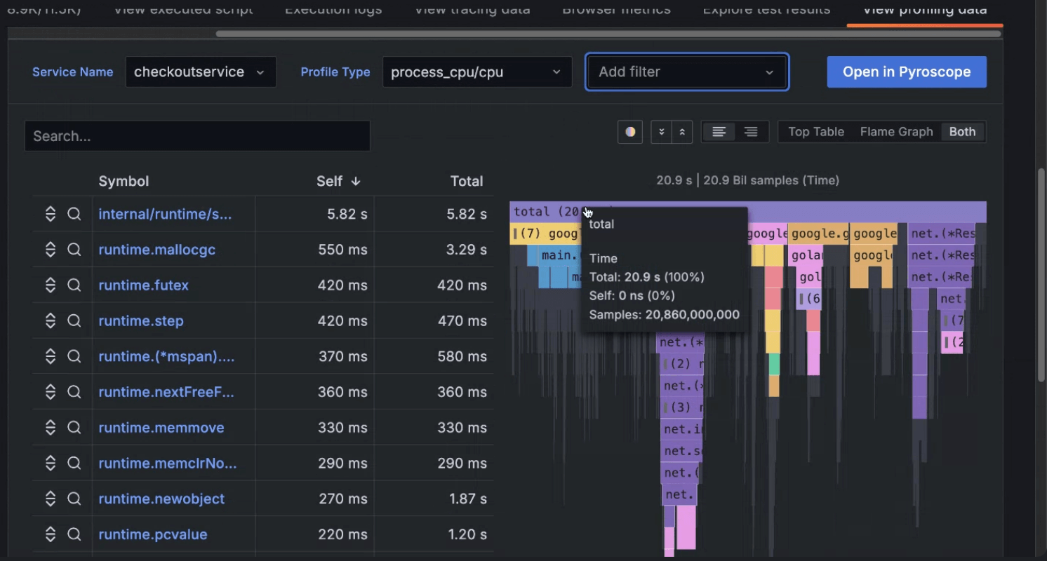

  3. In the test run results page, at the bottom of the page, locate the Profile tab.
A screenshot of the Profile tab in Grafana Cloud k6, showing the profiling data connected to the test run results
The Profile lets you view a flame graph of the profiling data generated by your application as a result of the load test you’re inspecting. You can use this data to find bottlenecks in your application and know exactly what line of code needs to be fixed.
The Profile tab has several options:
  • Service Name: A drop-down list of all of the services that have profiles. One service may collect multiple profile types.
  • Profile Type: Any service that the profile collects. The supported profile types vary based on the SDK and the programming language.
  • Filters: The Add filter drop-down lets you choose which additional filters you want to use.
    • Scenario: The name of the scenario in the k6 test script.
    • URL: The URL values sent by requests made in the k6 test script.
  • Open in Pyroscope: Open Profiles Drilldown with the same service, profile, and filters applied to it.
You can modify the flame graph similarly to the Profiles Drilldown application.

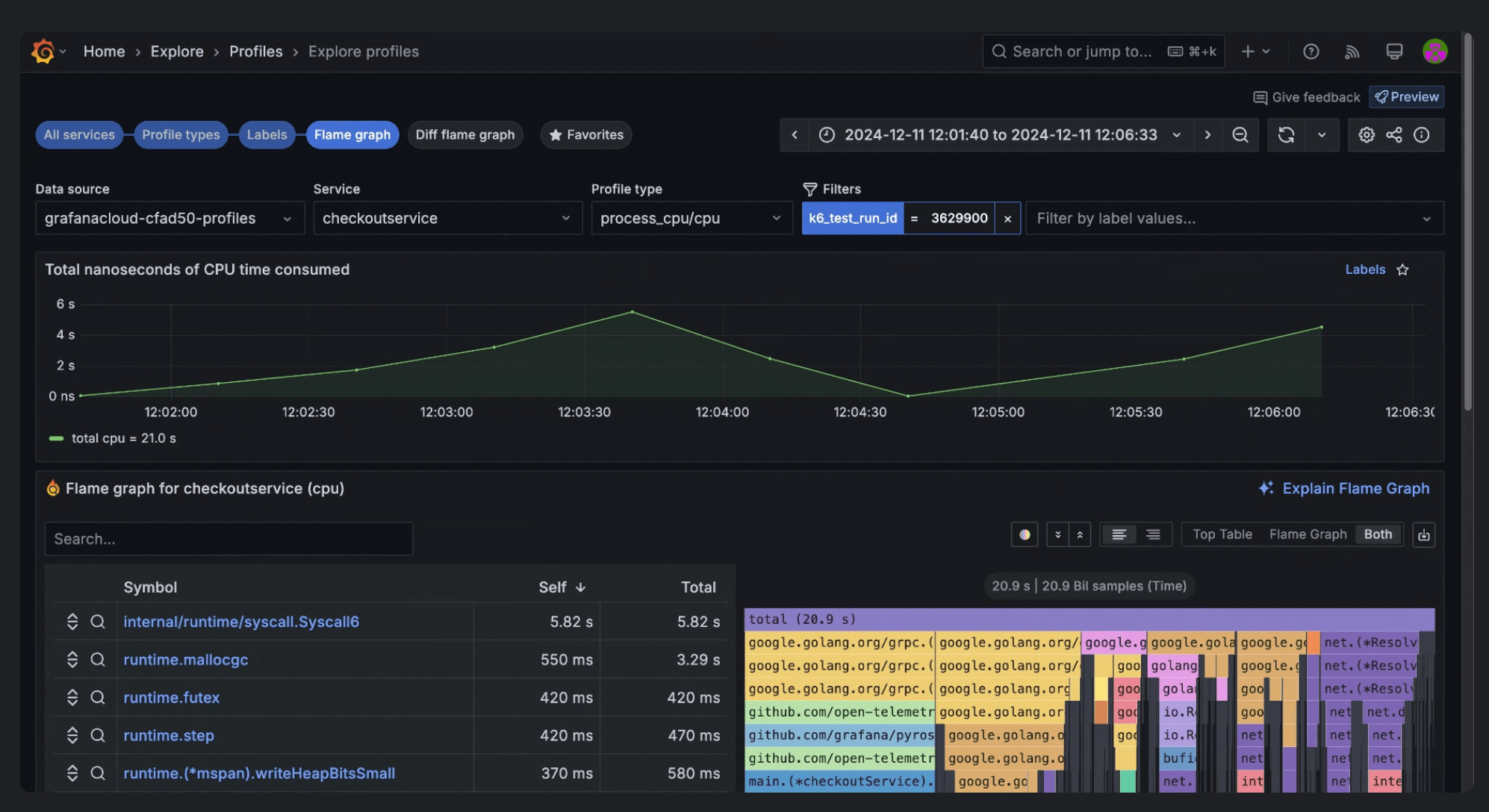

When you’re in the Profile tab of a k6 test run result, Select Open in Pyroscope to open Profiles Drilldown.
Profiles Drilldown provides an intuitive interface for exploring your profile data. Using Profiles Drilldown, you can get a high-level view of all of your services and how they’re functioning, find areas to optimize your services, or identify root causes of issues.

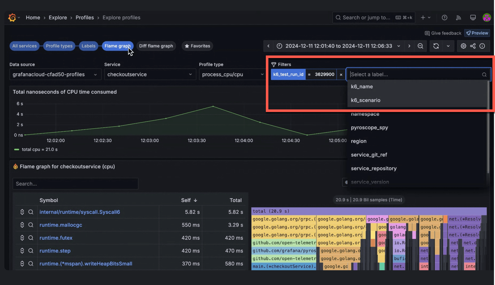

A screenshot of the Profiles Drilldown application, with a filter for k6_test_run_id configured
All of the parameters used in the Profile tab in k6 are automatically set in Profiles Drilldown, such as the test run id and time range of the k6 test. This allows you to navigate throughout the Profiles Drilldown app and further explore the profiling data.
When you select other profiles, some filters may be removed. This occurs because some profile types don’t support dynamic labels, so they won’t have the k6 test run metadata as labels. To add these filters back again, you can use the Filters section of Profiles Drilldown query builder.
A screenshot of the Profiles Drilldown application, with a filter for k6_test_run_id configured, and the “Select a label” dropdown expanded showing the k6_name and k6_scenario labels

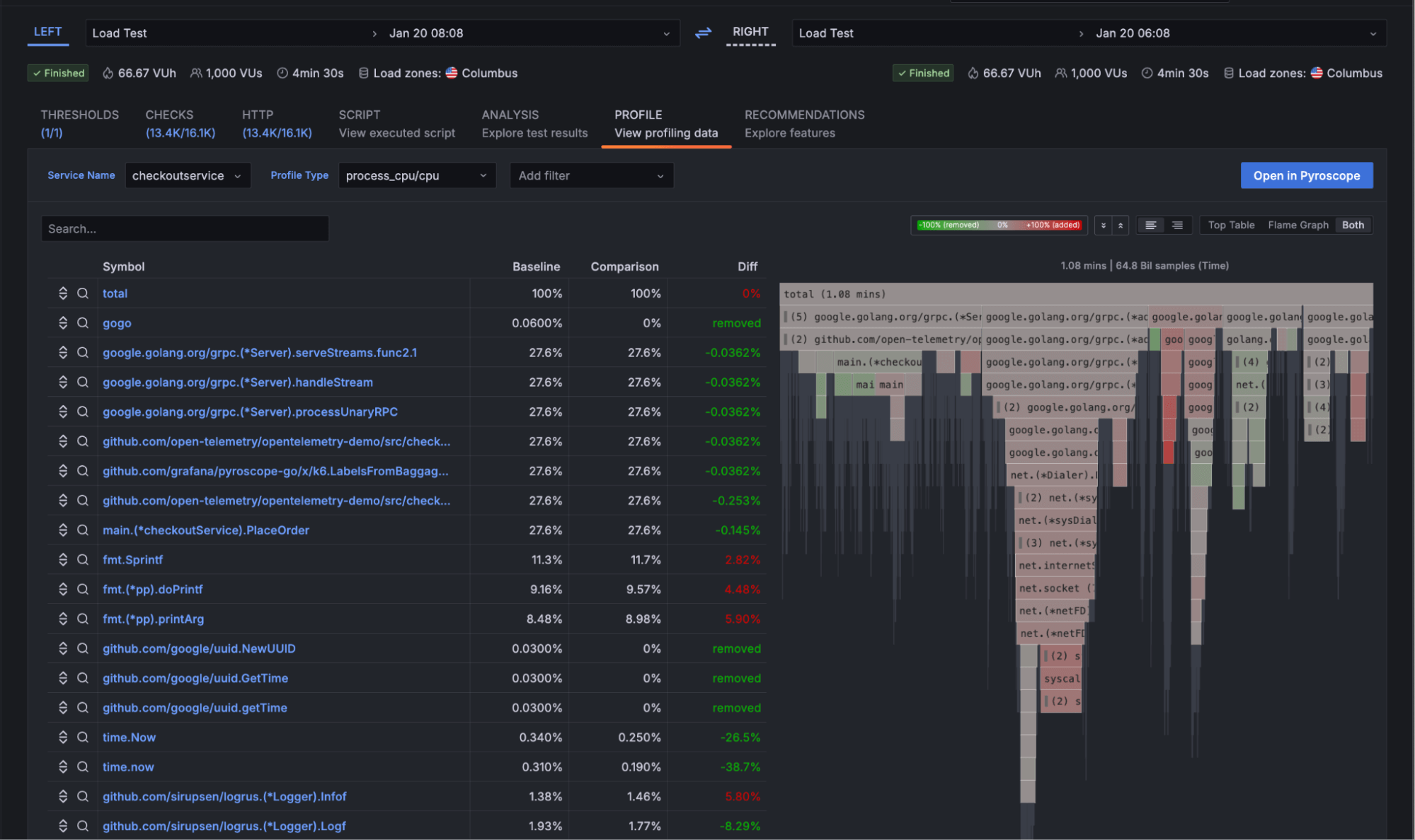

The layout of the page changes when you’re comparing test results. The left side shows the baseline test, and the right side shows the comparison test.
When you open the Profile tab in comparison mode, you can see a diff flame graph. It provides an overview to investigate what happened between two test runs. You can click on Open in Pyroscope to go to Profiles Drilldown, and see the same diff flame graph view, and continue to investigate any bottlenecks or performance issues in your application.
A screenshot of the Profile tab in Grafana Cloud k6, with two tests being compared and showing a diff flame graph
