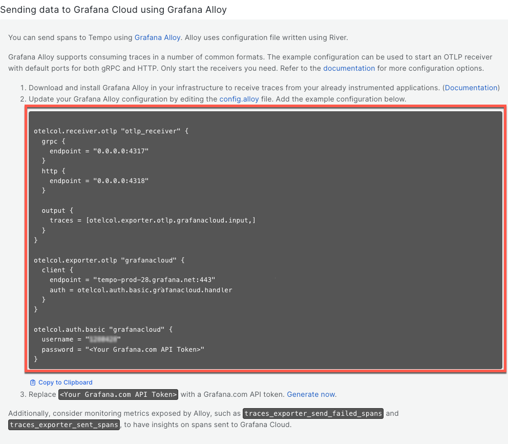

  1. Navigate to the Grafana Cloud stack you want to send traces to.
  2. Select Details from the Tempo section.
  3. Generate a new token for sending data by selecting Generate now in the Sending data to Grafana Cloud using Grafana Alloy section. Copy the token.
  4. Open or create an Alloy configuration file. The file location varies depending on your operating system. If the file doesn’t exist, you need to create it. Refer to Configure Grafana Alloy for more information.
    • Linux: /etc/alloy/config.alloy
    • macOS: $(brew --prefix)/etc/alloy/config.alloy
    • Windows: %ProgramFiles%\GrafanaLabs\Alloy\config.alloy
  5. Copy the example configuration file from the Sending data to Grafana Cloud using Grafana Alloy section. Example configuration file
  6. Paste your configuration into Alloy configuration file. Refer to Example configuration file for an example.
  7. Save the changes to your configuration file.
  8. Stop and restart Alloy. Refer to the Run Grafana Alloy documentation for details.

If you use this example configuration file, replace the placeholder values in your configuration file with your actual Grafana Cloud credentials:
  • Change <YOUR_GRAFANA_CLOUD_TRACES_ENDPOINT> to your Grafana Cloud traces endpoint, for example, https://tempo-us-central1.grafana.net:443
  • Change <YOUR_GRAFANA_CLOUD_INSTANCE_ID> to your instance ID, for example, 123456
  • Change <YOUR_GRAFANA_CLOUD_API_TOKEN> to your API token, for example, glc_eyJhbGciOiJIUzI1NiIsInR5cXXXXXXXVCJ9
alloy
// Receive OTLP traces on port 4317 (gRPC) and 4318 (HTTP)
otelcol.receiver.otlp "default" {
 grpc {
   endpoint = "0.0.0.0:4317"
 http {
   endpoint = "0.0.0.0:4318"
 output {
   traces = [otelcol.processor.batch.default.input]
// Batch traces before exporting
// Recommended for production environments.
otelcol.processor.batch "default" {
   // Wait until receive 1000 samples, up to a maximum of 2000.
   send_batch_size = 1000
   send_batch_max_size = 2000
   // Or until 2 seconds have elapsed.
   timeout = "2s"
   // When the Alloy has enough batched data, send it to the OpenTelemetry exporter named 'tempo' for traces,
   // or the Prometheus exporter for metrics.
   output {
       traces = [otelcol.exporter.otlp.grafanacloud.input]
// Export traces to Grafana Cloud
otelcol.exporter.otlp "grafana_cloud_traces" {
 client {
   endpoint = "<YOUR_GRAFANA_CLOUD_TRACES_ENDPOINT>:443"
   auth     = otelcol.auth.basic.grafanacloud.handler
// Configure authentication for Grafana Cloud
otelcol.auth.basic "grafana_cloud_traces" {
 username = "<YOUR_GRAFANA_CLOUD_INSTANCE_ID>"
 password = "<YOUR_GRAFANA_CLOUD_API_TOKEN>"
