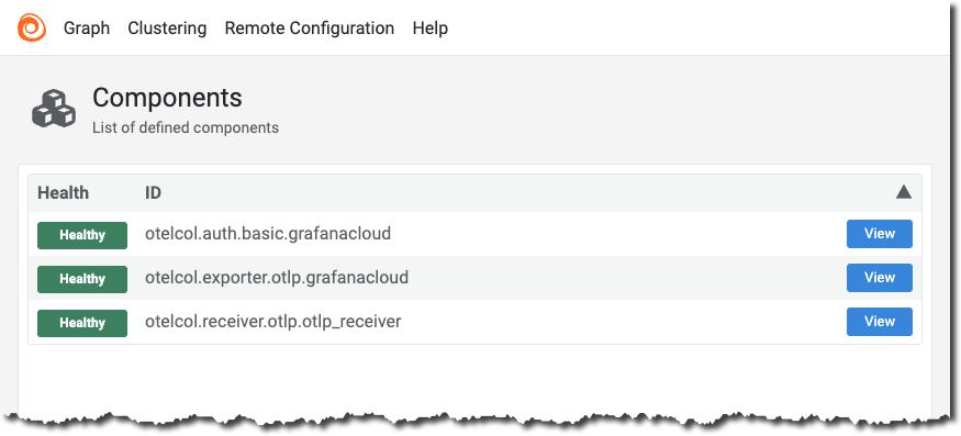

Check Alloy component status
To verify Alloy is running and check component status:
  1. Open your web browser and navigate to http://localhost:12345 to access the Alloy web interface. You can use the web UI to monitor component status and trace flow.
    The web UI shows the status of each component, including the otelcol.receiver.otlp, otelcol.processor.batch, and otelcol.exporter.otlp components. Grafana Alloy web interface showing the status of components including the otelcol.receiver.otlp, otelcol.processor.batch, and otelcol.exporter.otlp components.

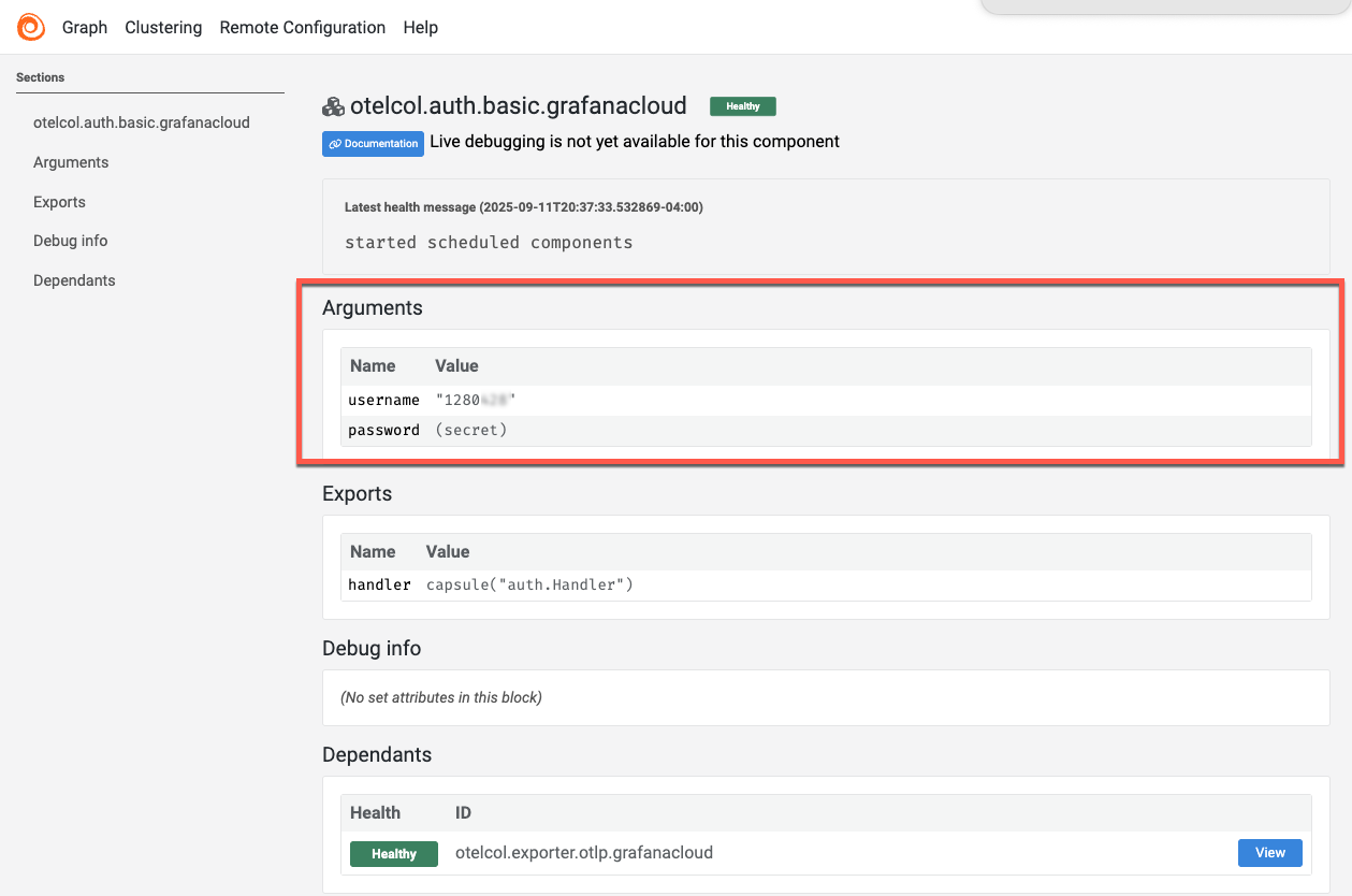

Verify authentication configuration
To verify that your Cloud username is correctly passed to Alloy, follow these steps:
  1. In the Alloy web UI, select otelcol.auth.basic.grafanacloud from the Components list.
  2. Under the Arguments section, verify that the username field matches your Grafana Cloud instance ID. Grafana Alloy web interface showing the otelcol.auth.basic.grafanacloud component with the username field under Arguments.
