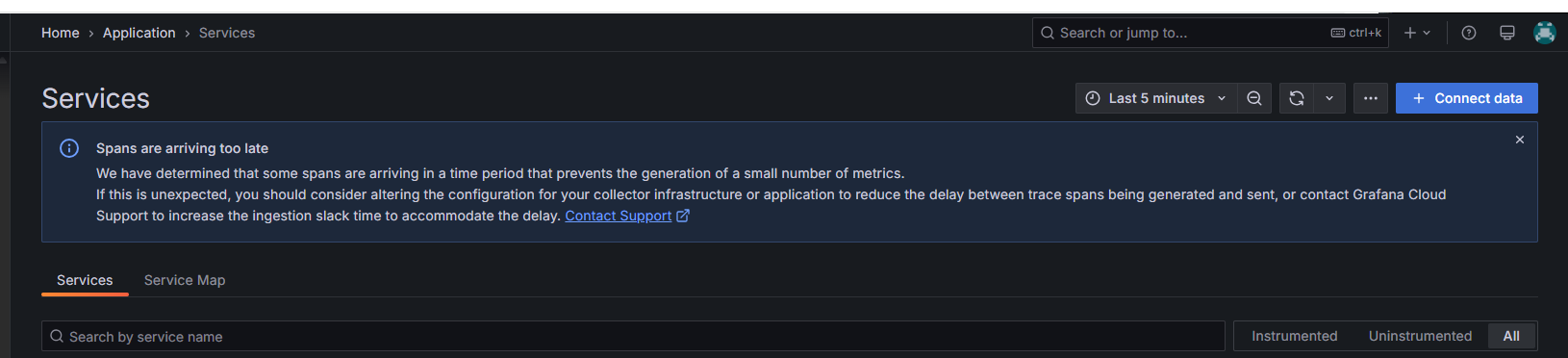

Spans arrive too late warning
The Spans are arriving too late message in Application Observability means some spans ingested into Grafana Cloud Traces aren’t used to generate metrics. These spans remain available in Grafana Cloud Traces for querying with TraceQL and can be rendered as part of the trace the spans belong to.
Spans arriving too late error message in the Services panel
Spans arrive too late when their end time is earlier than the slack period configured in Grafana Cloud Traces. By default, this slack period is 30 seconds. The metrics-generator discards spans that end earlier than the 30 second period before they are processed. Any relevant metrics for those spans aren’t updated.
For example, span counts and total call times for specific spans aren’t incremented.
Application Observability relies on the metrics generated from incoming spans. When these spans are discarded, then a service’s RED metrics (such as P95, error rate, and request rate) don’t provide completely accurate data.
Discarded spans don’t appear in PromQL queries executed against metrics generated by incoming spans to Grafana Cloud Traces. Because the spans were discarded by the metrics-generator, you receive a skewed view of your span data. TraceQL metrics queries show data as expected, because all of the spans are stored in Grafana Cloud Traces.
