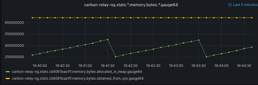

The graph below shows the result of querying the carbon-relay-ng.stats.*.memory.bytes.*.gauge64 series. Each carbon-relay-ng emits two metrics related to memory bytes (allocated_in_heap and obtained_from_sys).
Example graph querying last 5m for two series

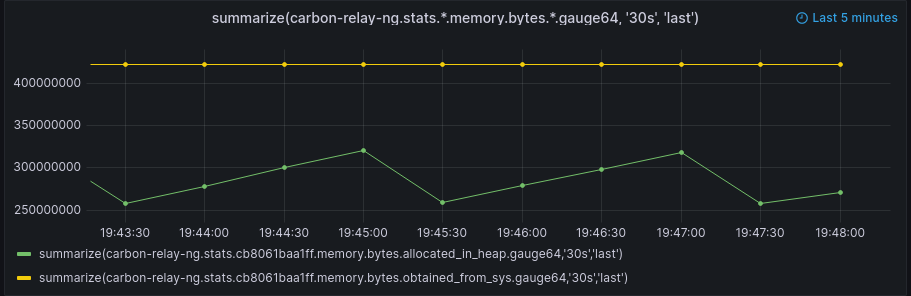

The graph below is querying summarize(carbon-relay-ng.stats.*.memory.bytes.*.gauge64, '30s', 'last'). This horizontally aggregates the points in each series.
Example graph querying last 5m for two series and using summarize on them
