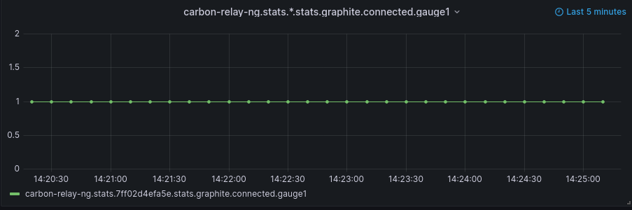

If you’re using carbon-relay-ng to send metrics, by default it will emit carbon-relay-ng.stats.*.stats.graphite.connected.gauge1 every 10 seconds with a constant value of 1.

aggregationMethod = sumThe first retention is 10s:10m. This means queries for data within the last 10 minutes will be returned with an interval of 10 seconds. The graph below uses the query carbon-relay-ng.stats.*.stats.graphite.connected.gauge1 in the past five minutes, so each result series has 1 point every 10 seconds. The value of each point is 1, as the retention interval matches the ingestion interval, so no horizontal aggregation is done.

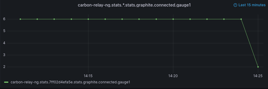

The second retention is 1m:1d. This means queries for data within the last day will be returned with an interval of 1 minute. The graph below uses the query carbon-relay-ng.stats.*.stats.graphite.connected.gauge1 in the past fifteen minutes, so each result series has 1 point every minute. The retention interval is 6 times larger than the ingestion interval. This means 6 points are horizontally aggregated into a single point. The value of each point is 6. aggregationMethod = sum for these series, so we sum the values of the 6 raw datapoints in every interval.

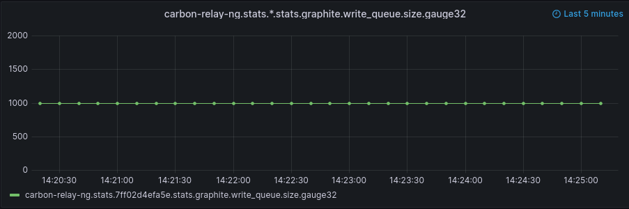

The graph below queries for carbon-relay-ng.stats.*.stats.graphite.write_queue.size.gauge32 in the past five minutes. Similar to the previous example, each result series has 1 point every 10 seconds. Because the retention interval matches the ingestion interval, no horizontal aggregation is done.

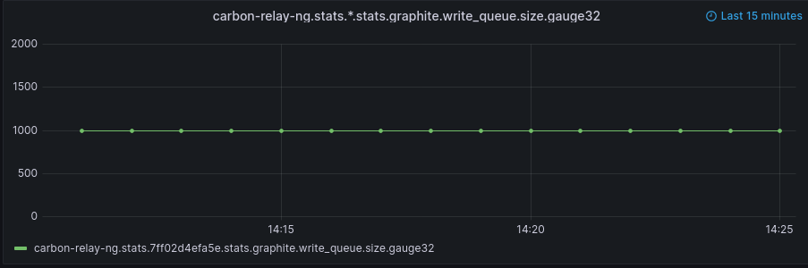

The graph below queries for carbon-relay-ng.stats.*.stats.graphite.write_queue.size.gauge32 in the past 15 minutes, so each result series has 1 point every minute. The 6 raw datapoints per interval are aggregated using average.

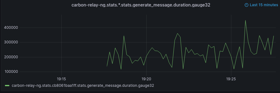

If you’re using carbon-relay-ng to send metrics, by default it will emit carbon-relay-ng.stats.*.stats.generate_message.duration.gauge32 every 10 seconds.
Assuming the following storage-schemas.conf rule is used:
[carbon_relay_ng_short_retention_example]
pattern = carbon-relay-ng.stats.*.stats.generate_message.duration.gauge32
retentions = 10s:10mUnlike the previous examples, it doesn’t have the 1m:1d retention.
The last retention in this rule is 10m. This means only data from the past 10 minutes is returned.
The graph queries carbon-relay-ng.stats.*.stats.generate_message.duration.gauge32 in the last 15 minutes. Due to the storage-schema.conf, no points are displayed for data older than 10 minutes.

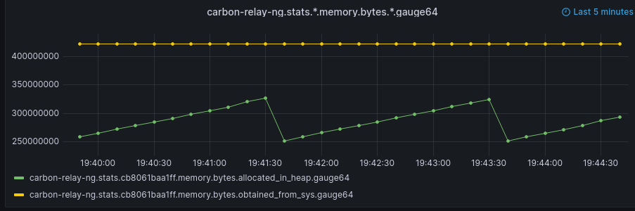

The graph below shows the result of querying the carbon-relay-ng.stats.*.memory.bytes.*.gauge64 series. Each carbon-relay-ng emits two metrics related to memory bytes (allocated_in_heap and obtained_from_sys).

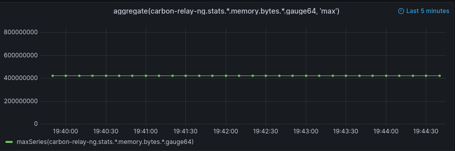

The graph below is querying aggregate(carbon-relay-ng.stats.*.memory.bytes.*.gauge64, 'max'). This vertically aggregates the points across series. In this case, the points are aggregated by choosing the maximum value at each interval.

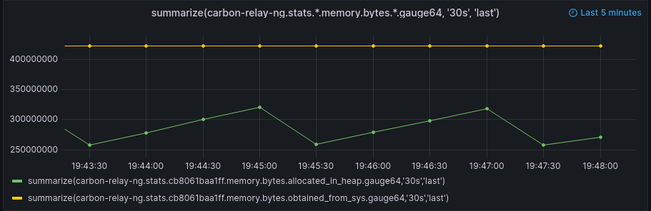

The graph below is querying summarize(carbon-relay-ng.stats.*.memory.bytes.*.gauge64, '30s', 'last'). This horizontally aggregates the points in each series.

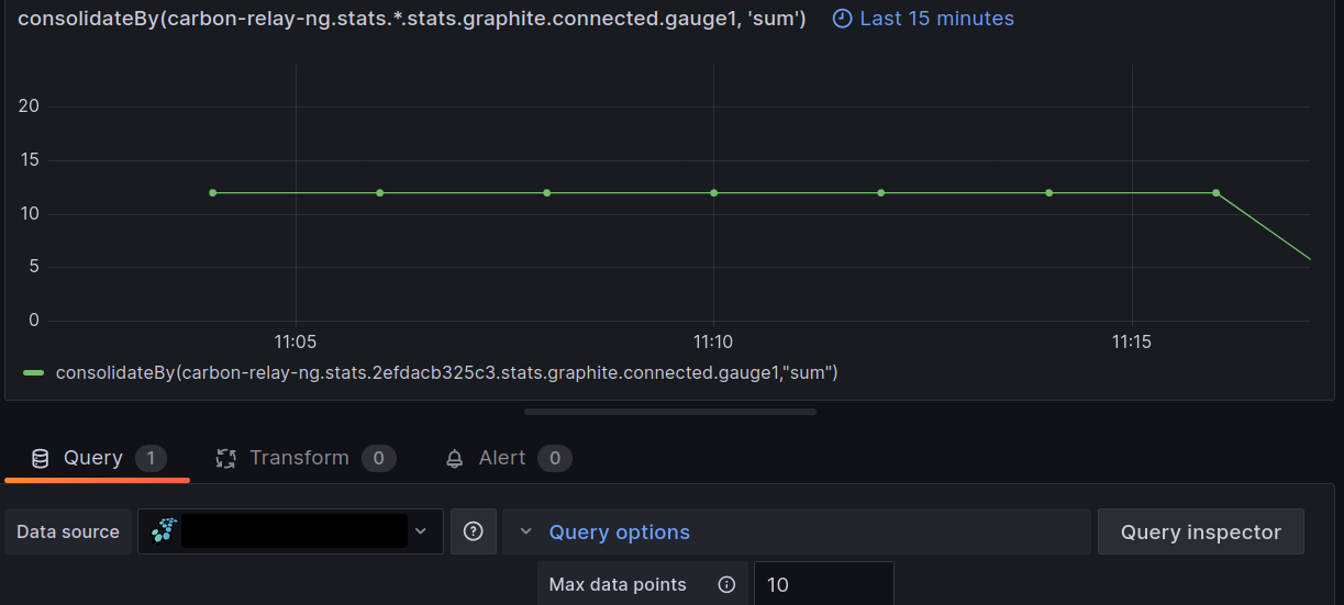

The graphs below use the same carbon-relay-ng.stats.*.stats.graphite.connected.gauge1 and schema files as Intervals aggregated with sum, As a reminder, these are emitted every 10 seconds with a constant value of 1 and aggregationMethod = sum in storage-aggregation.conf.
When maxDataPoints is greater than the number of points returned, the storage-schemas.conf intervals are used (1m intervals when querying for the last 15 minutes).

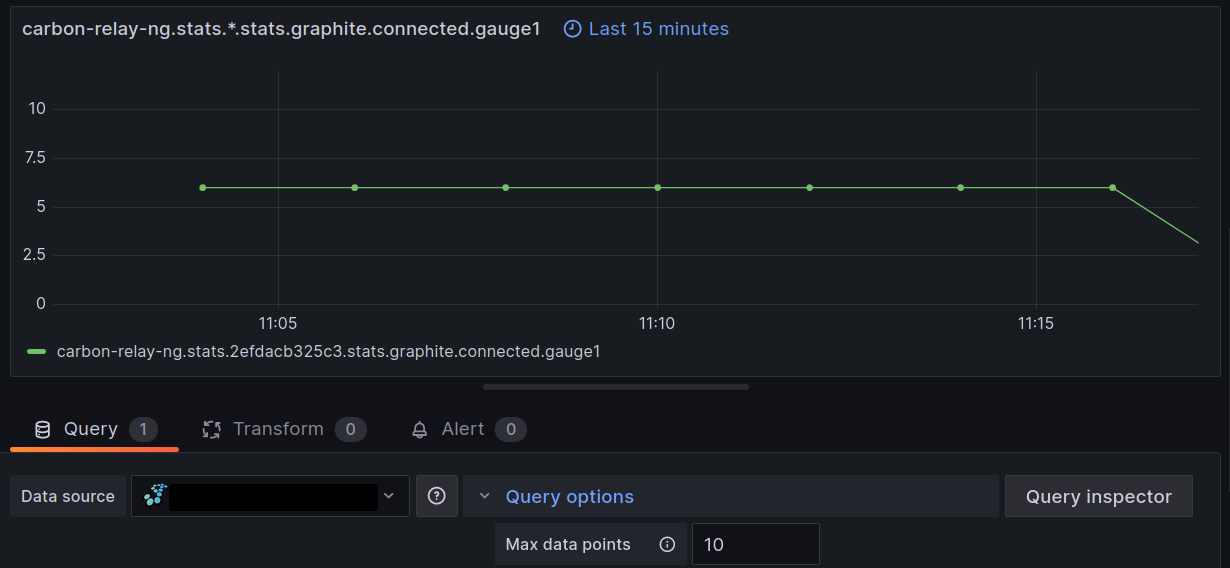

The graph below queries for the same metric, but maxDataPoints is restricted to 10, which causes the series to be horizontally aggregated further.
It just queries for carbon-relay-ng.stats.*.stats.graphite.connected.gauge1 with no additional functions. The schema file configurations are first applied to the raw datapoints, so the intermediate series have an interval of 1 minute, with the raw datapoints aggregated using sum. Each point in the intermediate series has a value of 6. maxDataPoints is then applied on the intermediate series. Due to the point limit, the interval is increase from 1 minute to 2 minutes. Therefore, the points in the intermediate series are aggregated using average as that is the default aggregation method for maxDataPoints. There are two intermediate points in each interval, so the averaged value is 6.
The graph below wraps the metric query with consolidateBy(sum). This updates the aggregation method used by maxDataPoints to sum. Therefore, the points in the intermediate series are aggregated using sum, so the final series have a value of 12 for each point.
