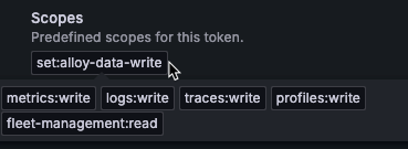

  2. Use the tool on this page to create a new token. Give the token a name and click the Create token button. You don’t need to complete the rest of the installation instructions if you’re not installing a new Alloy instance. The generated token comes with the predefined scope set:alloy-data-write, which includes scopes for reading remote configurations in Fleet Management and writing telemetry to Grafana Cloud databases. You can see the defined scopes by hovering over set:alloy-data-write:
    One section of the Alloy installation workflow in the Fleet Management interface in Grafana Cloud where a cursor hovers over the `set:alloy-data-write` scope to show that this scope includes scopes for `metrics:write`, `logs:write`, `traces:write`, `profiles:write`, and `fleet-management:read`.
