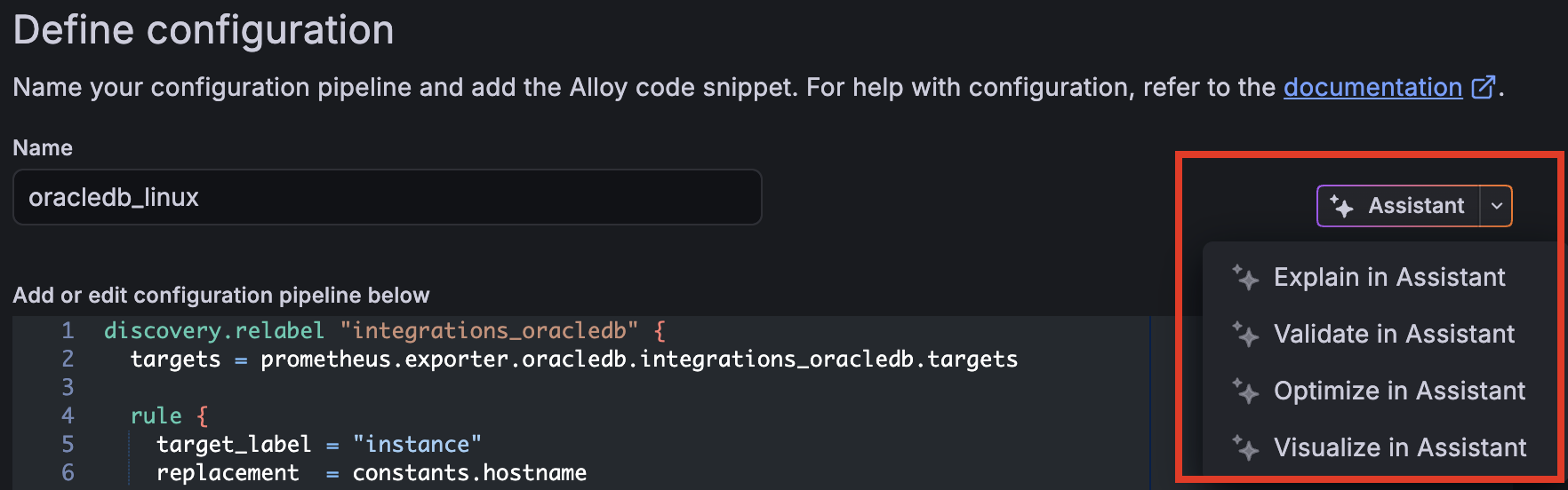

Define the configuration pipeline
  1. In your Grafana Cloud stack, click Connections > Collector > Fleet Management and then switch to the Remote configuration tab.
  2. Click Create configuration pipeline.
  3. Click Custom configuration and then Next.
  4. Enter a unique name for the pipeline.
  5. Insert one or more configuration snippets to create a pipeline. You can create your own using Alloy configuration syntax or select one of the snippets for Grafana Cloud integrations.
  6. Make sure the pipeline is complete. Each pipeline must be self contained and have the necessary components to send telemetry over the network to persistent storage.
    Note
    Components can be reused across pipelines with an advanced Fleet Management feature: pipeline export injection.
  7. If you want to label the telemetry you collect, inject collector attributes into the pipeline.
  8. Click Test configuration pipeline to validate the configuration syntax. The pipeline editor provides real-time feedback on the syntactic validity of the configuration content.
  9. Click Next to assign the configuration pipeline to collectors or click Save to save an incomplete pipeline.
    Defining and validating a new configuration pipeline named pyroscope_profiling.
