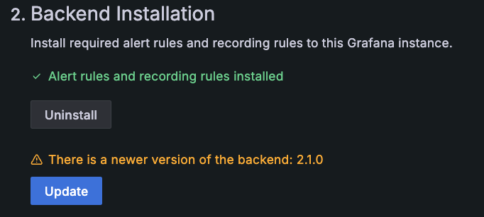

Update Kubernetes Monitoring features
When a new version of alerting rules and recording rules becomes available, an Update button is available within step 2 of the configuration steps on the Cluster configuration tab. Migration is not incremental. You are updated to the latest version.
To upgrade and install the latest alerting and recording rules to your Grafana instance, click Update on the Cluster configuration tab.
If you receive an error that the upgrade has failed, refer to troubleshooting instructions.

Testing the upgrade
- Click the Update button on the Cluster configuration tab to automatically recreate the recording and alert rules. Some alert descriptions may now contain more detail, and some new recording and alert rules appear. Some rule groups may be split or combined to improve evaluation performance.
