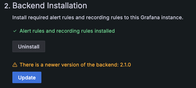

Update Kubernetes Monitoring features
When a new version of alerting rules and recording rules becomes available, an Update button is available within step 2 of the configuration steps on the Cluster configuration tab. Migration is not incremental. You are updated to the latest version.
To upgrade and install the latest alerting and recording rules to your Grafana instance, click Update on the Cluster configuration tab.
Update button showing a new backend version is available
If you receive an error that the upgrade has failed, refer to troubleshooting instructions.
