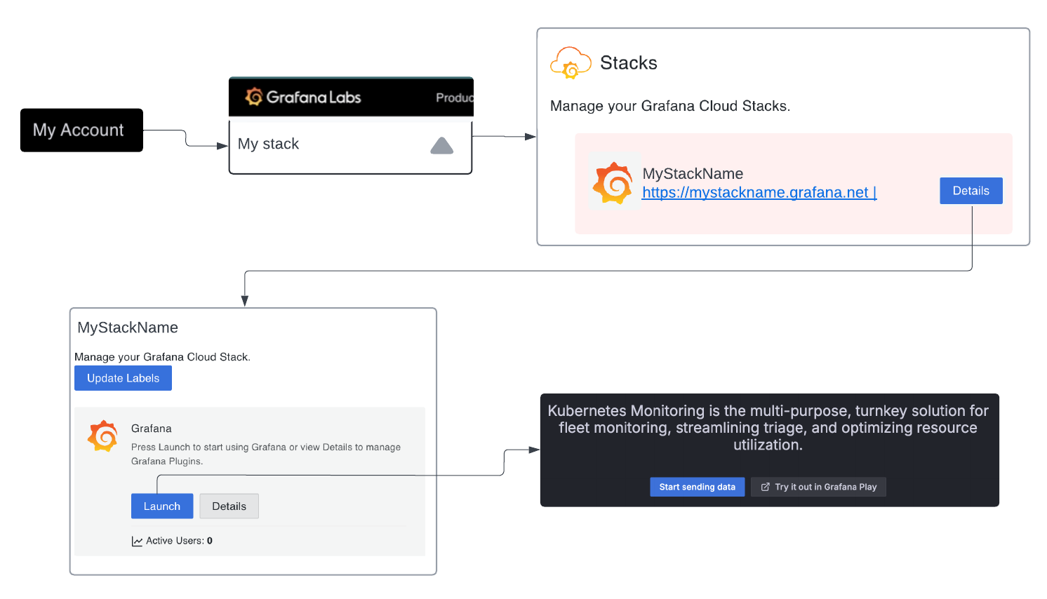

Send data from your account
If you need to send data to your account, complete the following steps:
Accessing your account to send data
  1. Go to your Grafana Cloud account, and click My Account.
  2. Select the stack where you want to install Kubernetes Monitoring.
  3. Click Details next to the name of your stack.
  4. At your stack page, click Launch to open Kubernetes Monitoring.
  5. Click Start sending data.
Kubernetes Monitoring displays the Cluster configuration tab of the Configuration page.

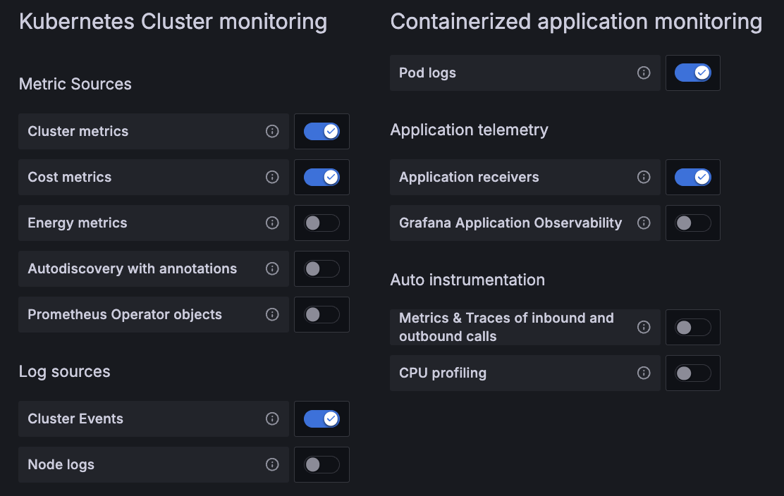

  4. Kubernetes Cluster monitoring: Data collection for infrastructure metrics and logs. Switch on or off the following options.
    Note
    These options are independent of each other. For example, disabling cost or energy metrics does not disable any other option. Refer to additional information for each option by following the links and review Manage your Kubernetes configuration.
  5. Containerized Cluster monitoring: Data collection for containerized applications. Switch on or off the following options.
    • Pod logs
    • Application receivers, to receive data from the receivers OTLP/gRPC, OTLP/HTTP, and Zipkin
    • Grafana Application Observability, to collect host metrics required by Application Observability
      Caution
      If you enable Application Observability, this may affect your billing. Refer to Host-based pricing for more details.
    • Metrics and traces of inbound and outbound calls to deploy Grafana Beyla for automatic instrumentation of applications on the Cluster
      Caution
      If you enable automatic instrumentation with Beyla, this may affect your billing due to additional telemetry ingestion.
    • CPU profiling, to collect profiles from applications on the Cluster

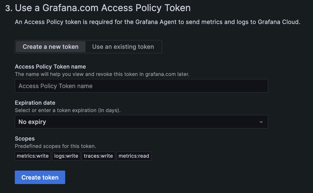

Use a Grafana.com access policy token
You can create a new access policy token or use an existing token. Refer to Grafana Cloud Access Policies for more information.
To use an existing token:
  1. Click Use an existing token.
  2. Paste the token into the Access policy token name box.
To create a new token:
  1. Click Create a new token.
  2. In the box for Access Policy Token name, enter the name of your token.
  3. In the Expiration date box, select an option for the expiration date.
    The permission scope for the token appears.
    Options for configuration, including expiration date
  4. Click Create token.
    The token generates and appears in the token box. This token is automatically copied into the ConfigMap file.
  5. Click the copy icon in the token box to copy the token. Make sure to save it in a secure place. It is not shown again.

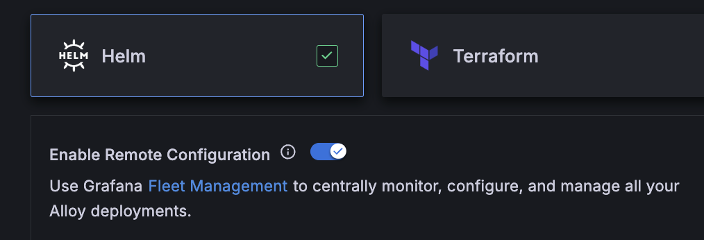

  1. Select the method of deployment.
  2. Optionally select Enable Remote Configuration to have Grafana Fleet Management centrally manage your Alloy deployments.
  3. Use the code or files for deployment, following the on-screen instructions.
Choices for deployment method and Fleet Management option
Helm client
To use the Helm client to deploy the Kubernetes Monitoring Helm chart to the Cluster:
  1. Copy the command.
  2. Paste and run it in your terminal.
Terraform
To use Terraform to deploy the Kubernetes Monitoring Helm chart to the Cluster:
  1. Copy, modify, and save the following files to your Terraform system set up using Terraform:
    • provider.tf
    • grafana-k8s-monitoring.tf
    • vars.tf
  2. Deploy by using the commandsterraform init and terraform apply.
Remote configuration
Select Enable Remote Configuration to use Fleet Management to monitor, configure, and manage your Alloy collectors. You can update your collectors without having to update the Cluster.

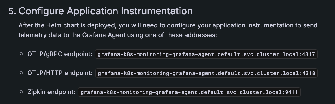

Configure application instrumentation
If you chose to include receivers in the Select features and enter cluster information section, a list of endpoints appear. In your application that generates metrics, logs, or traces, enter the appropriate OTLP or Zipkin address.
Endpoints available for configuration
Note
If you change the deployment name to something other than grafana-k8s-monitoring, the endpoint address is updated as well. Be sure to update your applications to point to the correct endpoint.
