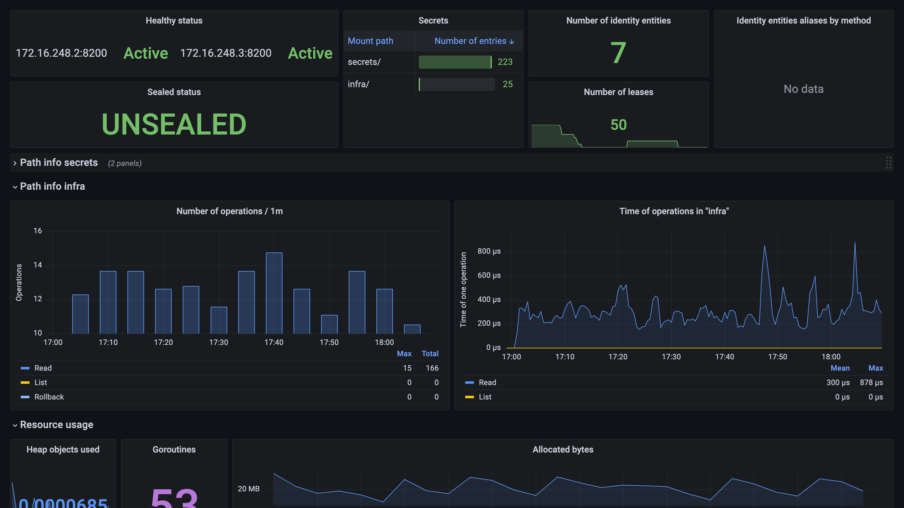

Dashboards
The Vault integration installs the following dashboards in your Grafana Cloud instance to help monitor your system.
  • Hashicorp Vault
Vault overview
Vault overview
