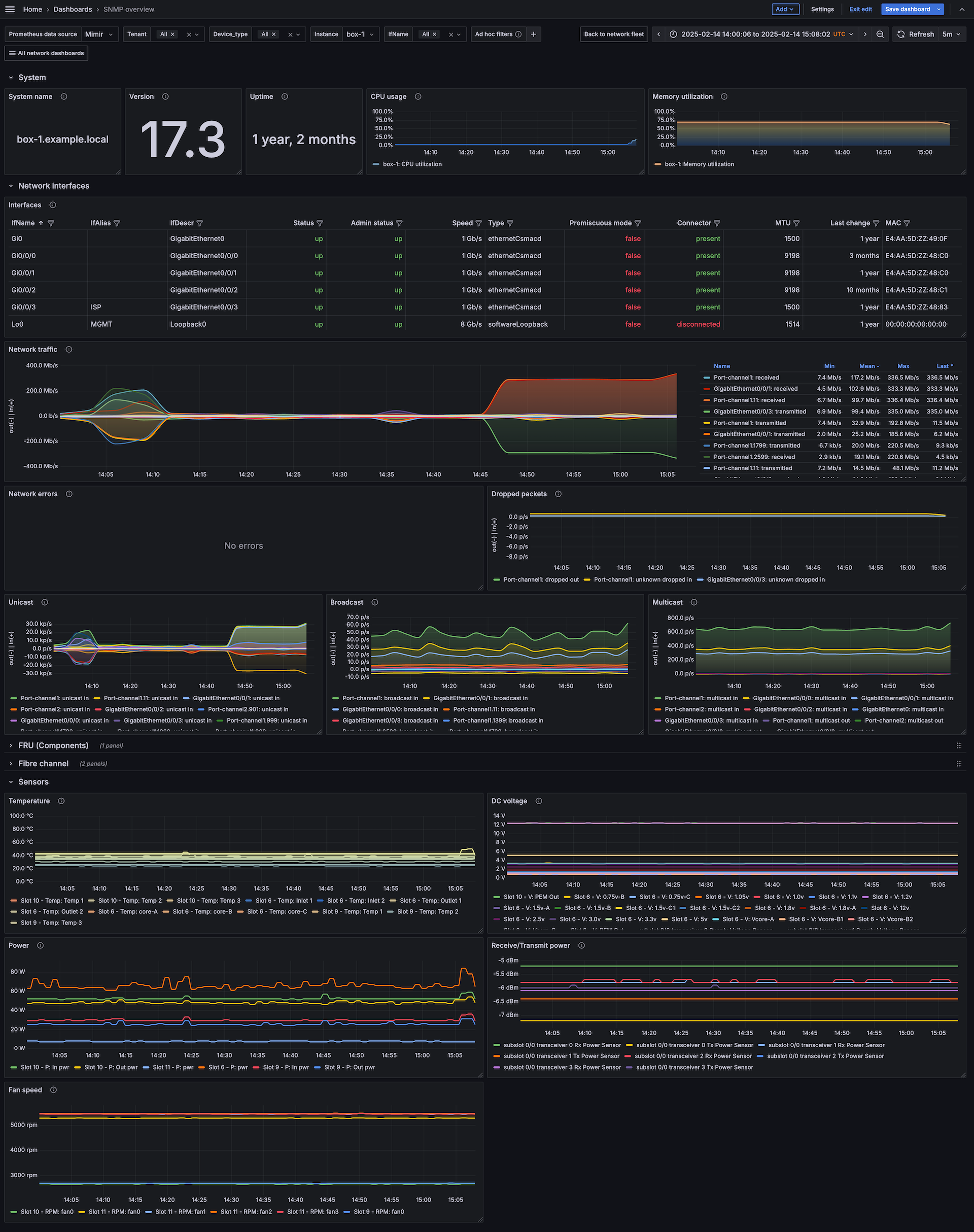

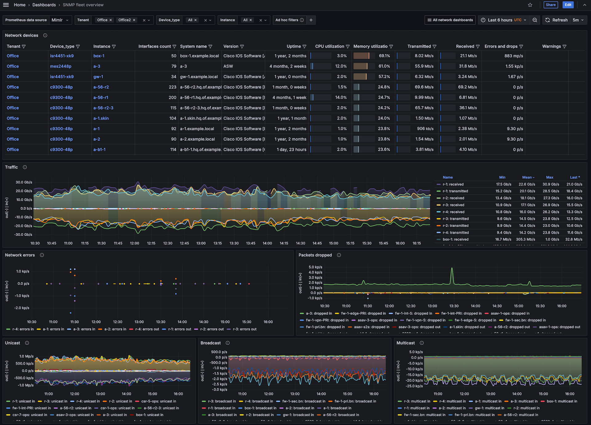

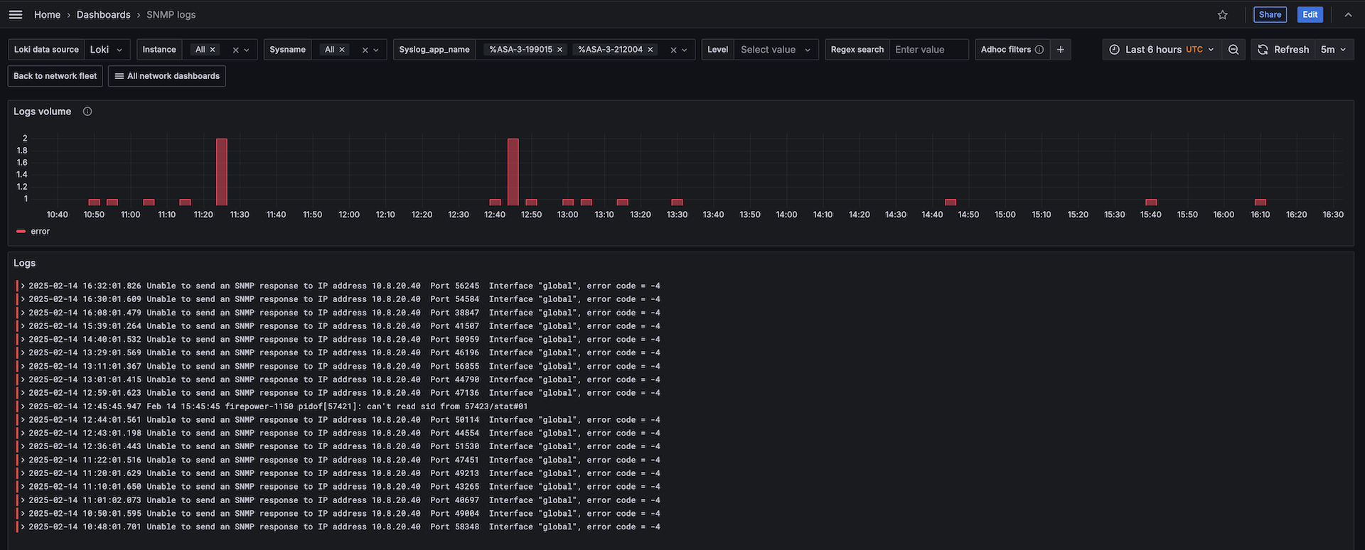

Dashboards
The SNMP integration installs the following dashboards in your Grafana Cloud instance to help monitor your system.
- SNMP fleet overview
- SNMP logs
- SNMP overview
SNMP fleet
SNMP overview
SNMP logs
