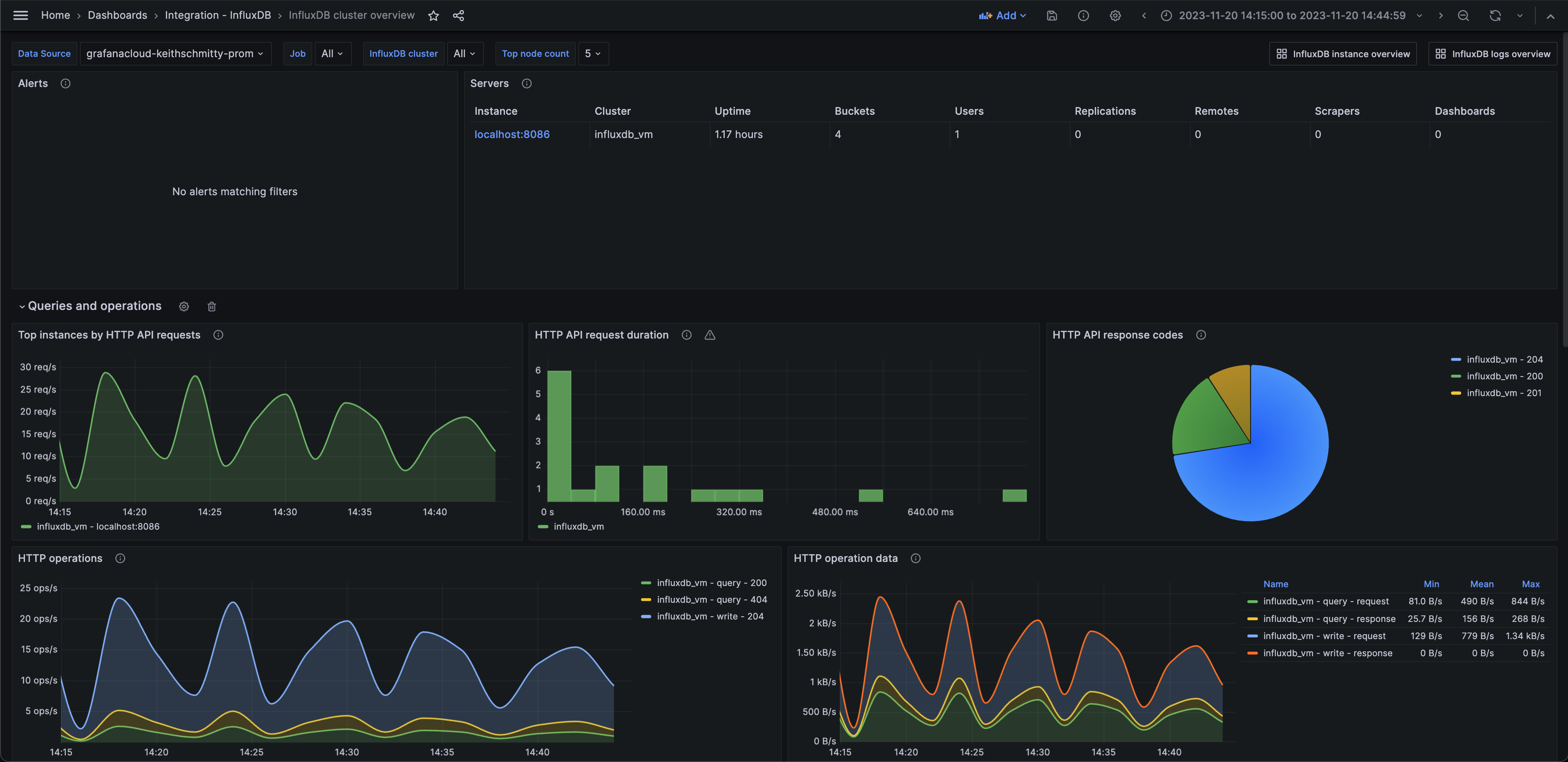

Dashboards
The InfluxDB integration installs the following dashboards in your Grafana Cloud instance to help monitor your system.
  • InfluxDB cluster overview
  • InfluxDB instance overview
  • InfluxDB logs overview
InfluxDB cluster overview (queries)

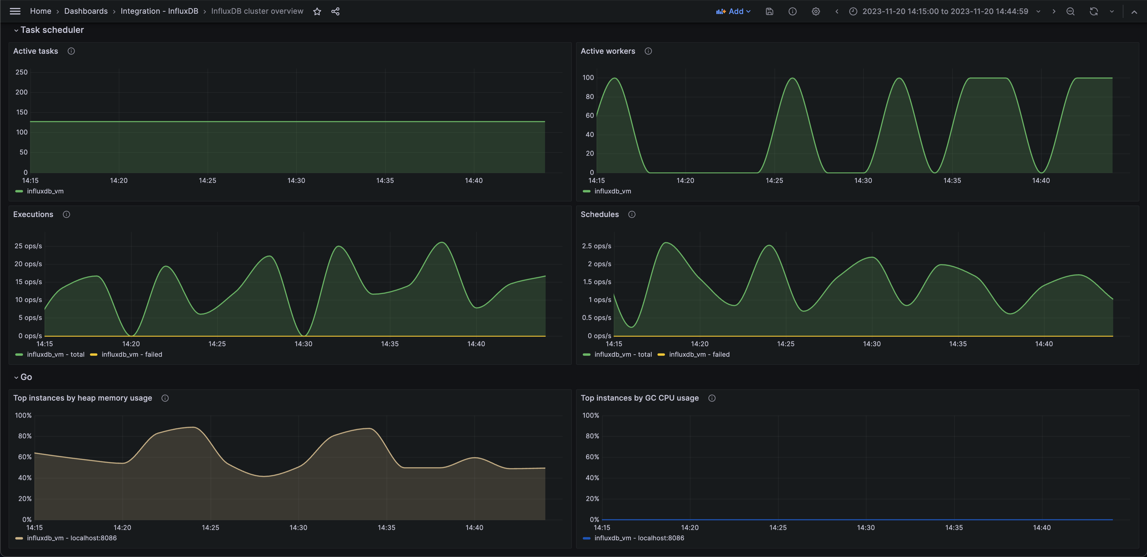

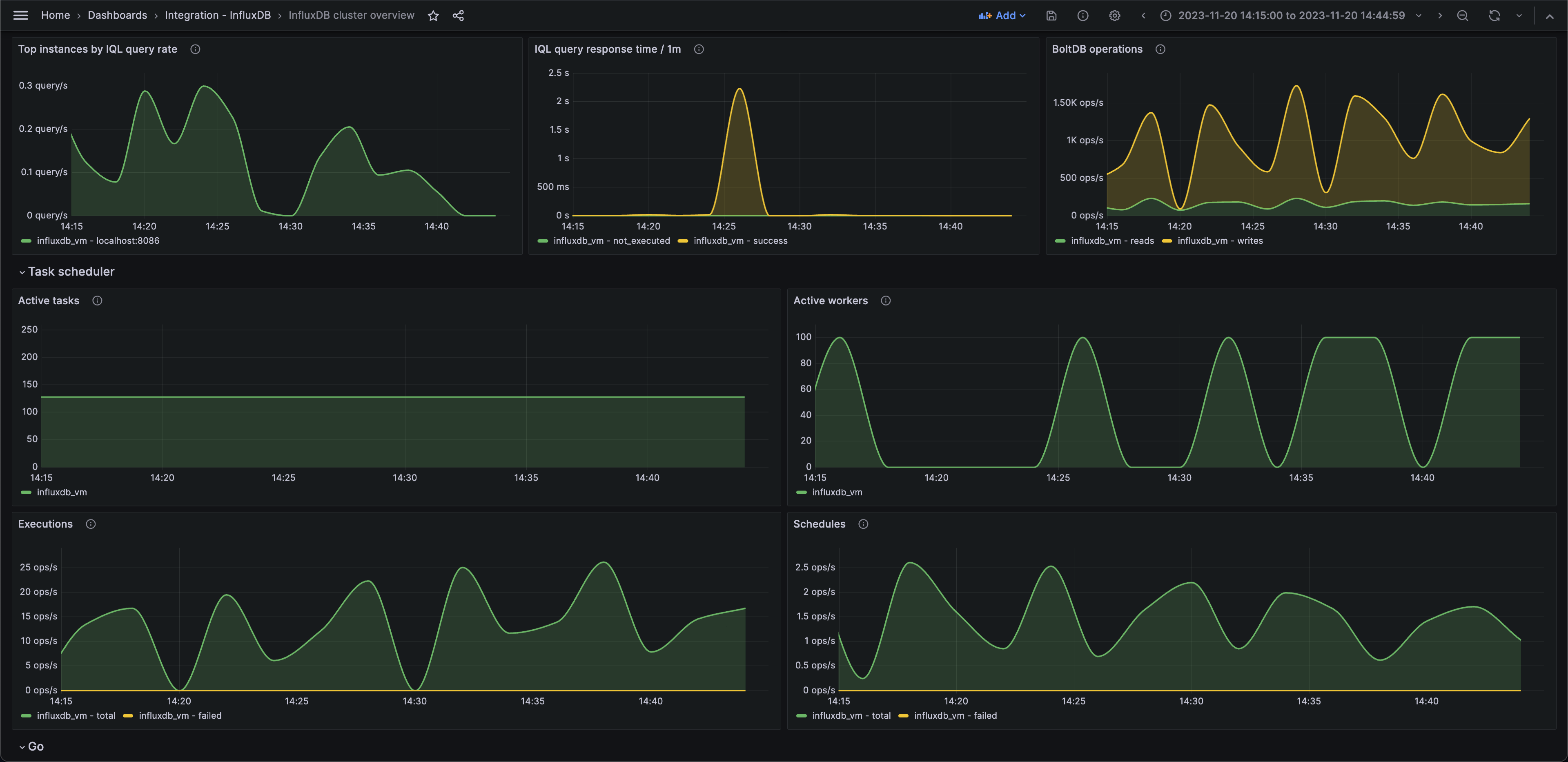

InfluxDB cluster overview (tasks)
InfluxDB cluster overview (Go)
