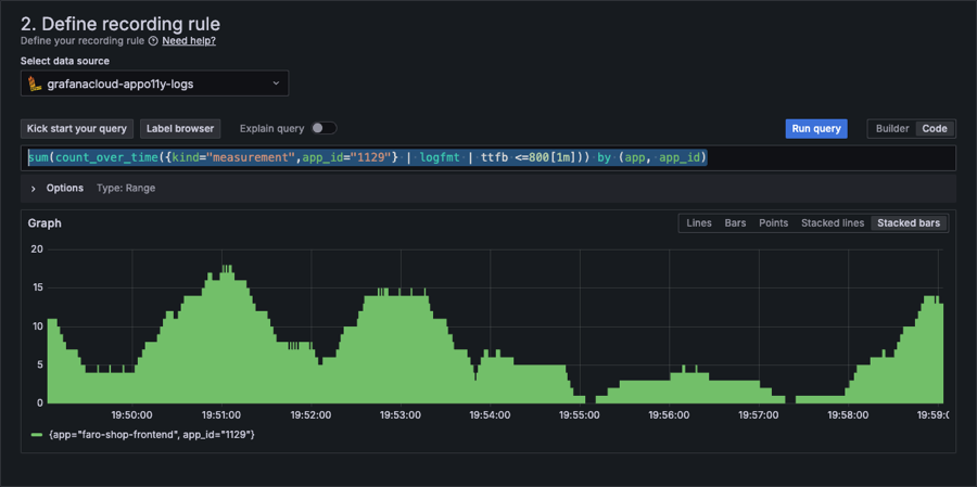

Define ttfb_success
Enter the following code to define your recording rule:
logql
sum(count_over_time({kind="measurement",app_id="1129"} | logfmt | ttfb <=800[1m])) by (app, app_id)
where:
  • kind="measurement": Filters logs to include only those marked as measurements
  • app_id="1129": Filters logs for the specific application
  • logfmt: Parses structured log fields
  • ttfb <= 800: Ensures only logs with TTFB less than or equal to 800ms are considered
  • count_over_time: Calculates the count of matching logs over a 1-minute interval
  • sum by (app, app_id): Aggregates the results by application and application ID
A step from the new recording rule wizard showing how to define a recording rule for the success metric

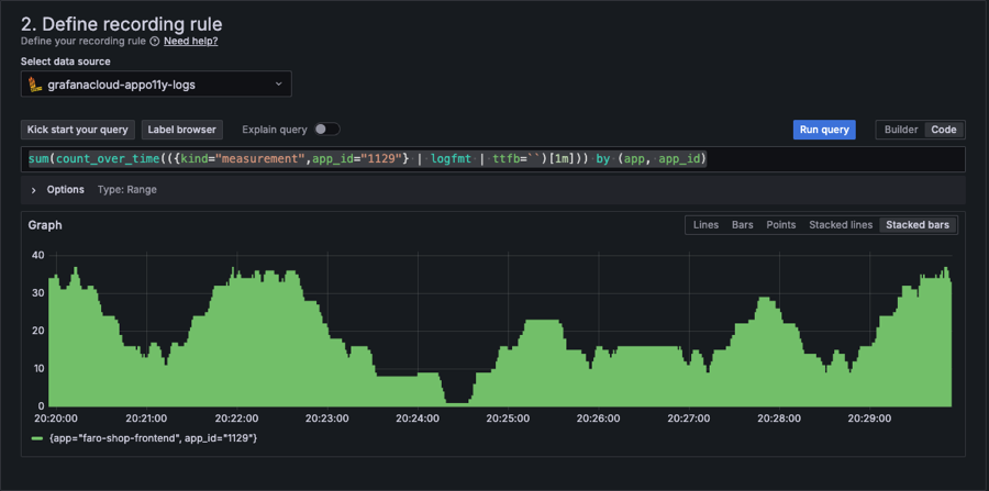

Define ttfb_total
For ttfb_total, count all TTFB observations without filtering for success criteria. Enter the following code to define your recording rule:
logql
sum(count_over_time(({kind="measurement",app_id="1129"} | logfmt | ttfb=``)[1m])) by (app, app_id)
where:
  • ttfb='': Ensures the TTFB field is present in the log entry
A step from the new recording rule wizard showing how to define a recording rule for the total metric

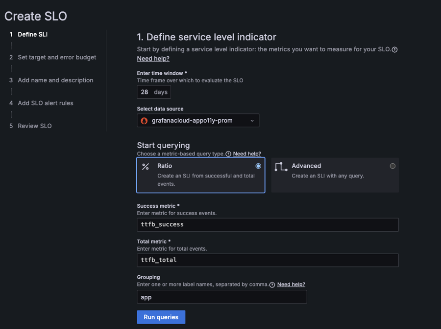

Define the SLO
  1. Choose the Success and Total Requests (SLI) option.
  2. Select:
    1. Success Metric: ttfb_success
    2. Total Metric: ttfb_total
A step from the create SLO wizard showing how to define the service level indicator the success metric and total metric
