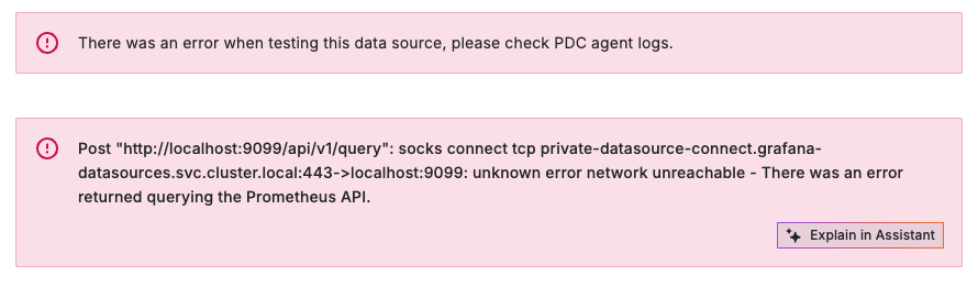

Some data source query errors have an error message containing a string like socks connect tcp private-datasource-connect.hosted-grafana.svc.cluster.local:443<ADDRESS>:<PORT>: unknown error <ERROR>. These errors can occur wherever a query is made in the UI: In the data source configuration page, in explore, or within a panel, for example. This is what the most common errors here mean:
network unreachable
The PDC system cannot find a PDC agent to send the request to. Make sure you have at least one PDC agent running and connected.
host unreachable
Most commonly, this means that a PDC agent fails to establish a TCP connection with the data source within 10 seconds. Check that the data source is reachable from where each PDC agent on a network is running.

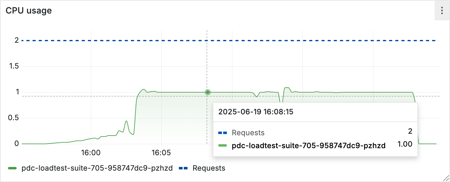

This occurs when request rates exceed the PDC agent’s capacity (typically 100-300 requests per second). In Grafana, this is usually visible as an increase in non-success replies: host unreachable, network unreachable, and general SOCKS server failure. On the PDC agent itself, the most reliable indicator is CPU usage reaching one full core.
Because OpenSSH is single-threaded, it cannot use more than one CPU core, so performance begins to degrade once this threshold is reached.
PDC agent CPU usage example
To reduce the load on an individual PDC agent, deploy additional PDC agents with the same configuration. You can use another token for the same PDC network if needed.
