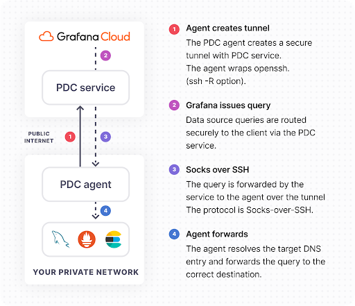

Instead of implementing a VPN solution, Grafana has built a solution that allows you to route queries to many isolated networks without having to worry about overlapping subnets. Queries and data are routed and encrypted from your Grafana instance via the PDC agent deployed within your network. As a result, PDC is entirely within your control, since you deploy and manage the agent.
PDC provides the ability for customer-operated SOCKS5 SSH tunnels that connect to a Grafana Cloud managed tunneling reverse proxy that communicates directly with your Grafana Cloud instance and encrypts traffic with a customer-provided SSH key.
PDC operates at a high level in the following manner:
The PDC agent initiates an SSH connection with the Grafana data source connect service. The SSH client running in your network is configured with reverse dynamic forwarding* (_the* -R <port> option)._ In this mode, SSH acts as a SOCKS proxy and forwards connections to destinations requested by Grafana.
Whenever your Grafana instance needs to query your private data source, the TCP connection is wrapped in a secure SOCKS connection and then routed to the Grafana PDC service.
SOCKS packets are forwarded to the PDC agent through the SSH connection.
The PDC agent resolves the DNS of the data source endpoint and establishes a secure connection to the data source.

The monitoring and supervision of the SSH tunnel are delegated to an agent running inside your private network. At any time, you can shut off the agent, which terminates the connection. PDC is entirely within your control, since you deploy and manage the agent.
The agent running inside your private network is a horizontally scalable component to ensure fault-tolerance. This means you can deploy multiple agents within the same network, and Grafana Cloud load balances across them automatically.
Traffic is encrypted all the way from your Grafana Cloud stack to the SSH client running in your private network. If the private data source supports encryption (for example, HTTPS), traffic will be encrypted end-to-end.
In your Grafana Cloud instance, you will be able to configure compatible data sources to route requests through the SSH tunnel. Each data source is configured using the internal DNS name (for example, mysql.your.domain:3306), as if Grafana were running directly inside the private network.
