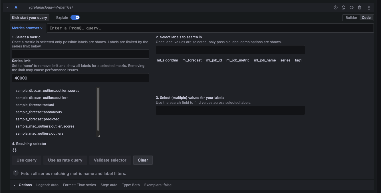

Code mode
Code mode is for the experienced Prometheus user with prior expertise in PromQL, Prometheus’ query language. The Code mode editor allows you to create queries just as you would in Prometheus. For more information about PromQL see Querying Prometheus.
The user interface (UI) also lets you select metrics, labels, filters, and operations.
You can write complex queries using the text editor with autocompletion features and syntax highlighting. Code mode’s autocomplete feature works automatically while typing. The query editor can autocomplete static functions, aggregations, keywords, and also dynamic items like metrics and labels. The autocompletion drop-down includes documentation for the suggested items where available.
It also contains a Metrics browser to further help you write queries. To open the Metrics browser, click the arrow next to Metrics browser.
Metrics browser in Code mode
The Metrics browser locates metrics and selects relevant labels to help you build basic queries.
When you click Metrics browser in Code
mode, it displays all available metrics and labels.
If supported by your Prometheus instance, each metric also displays its HELP
and TYPE
as a tooltip.
When you select a metric under Step 1, the browser narrows down the available labels to show only the ones applicable to the metric.
You can then select one or more labels shown in Step 2.
Select one or more values in Step 3 for each label to tighten your query scope.
In Step 4, you can select Use query to run the query, Use as rate query to add the rate operation to your query ($__rate_interval
), Validate selector to verify the selector is valid and show the number of series found, or Clear to clear your selections and start over.
Note
If you don’t remember the exact metric name, you can start by selecting a few labels to filter the list. This helps you find relevant label values and narrow down your options.
All lists in the Metrics browser include a search field to quickly filter metrics or labels by keyword.
In the Values section, there’s a single search field that filters across all selected labels, making it easier to find matching values. For example, if you have labels like app
, job
, and job_name
, only one of them might contain the value you’re looking for.
When you are satisfied with your query, click Run query.
