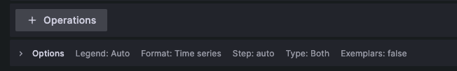

You can configure Prometheus-specific options in the query editor by setting several options regardless of mode.

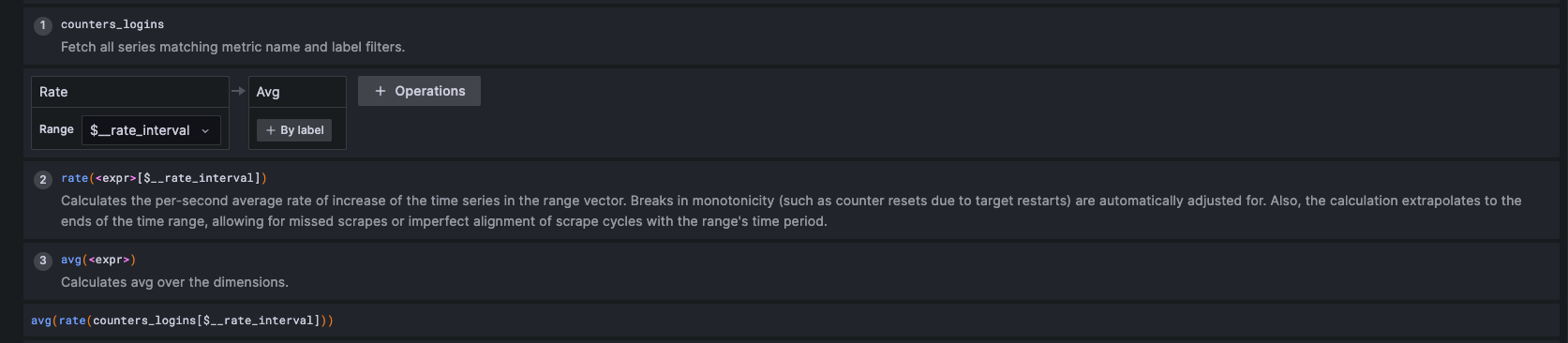

  • Explain - Toggle on to display a step-by-step explanation of all query components and operations.
Explain results
Explain results

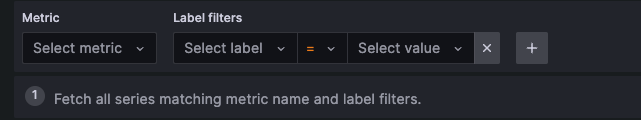

  • Metric - Select a metric from the drop-down. Click the icon to open Metrics explorer, where you can search for metrics by name and filter by type if your instance has a large number of metrics. Refer to Metrics explorer for more detail on using this feature.
  • Label filters - Select label filters from the drop-down. Select an operator and a value. Select desired labels and their values from the drop-down list. When a metric is selected, the data source requests available labels and their values from the server. Use the + button to add a label, and the x button to remove a label.

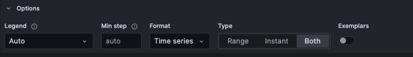

Options:
  • Legend- Lets you customize the name for the time series. You can use a predefined or custom format.
    • Auto - Displays unique labels. Also displays all overlapping labels if a series has multiple labels.
    • Verbose - Displays all label names.
    • Custom - Lets you customize the legend using label templates. For example, {{hostname}} is replaced with the value of the hostname label. To switch to a different legend mode, clear the input and click outside the field.
  • Min step - Sets the minimum interval between data points returned by the query. For example, setting this to 1h suggests that data is collected or displayed at hourly intervals. This setting supports the $__interval and $__rate_interval macros. Note that the time range of the query is aligned to this step size, which may adjust the actual start and end times of the returned data.
  • Format - Determines how the data from your Prometheus query is interpreted and visualized in a panel. Choose from the following format options:
    • Time series - The default format. Refer to Time series kind formats for information on time series data frames and how time and value fields are structured.
    • Table - Displays data in table format. This format works only in a Table panel.
    • Heatmap - Displays Histogram-type metrics in a Heatmap panel by converting cumulative histograms to regular ones and sorting the series by the bucket bound. Converts cumulative histogram data into regular histogram format and sorts the series by bucket boundaries for proper display.
  • Type - This setting determines the query type. These include:
    • Both - The default option. Returns results for both a Range query and an Instant query.
    • Range - Returns a range vector - a set of time series a set of time series where each series includes multiple data points over a period of time. You can choose to visualize the data as lines, bars, points, stacked lines, or stacked bars.
    • Instant - Returns a single data point per series — the most recent value within the selected time range. The results can be displayed in a table or as raw data. To visualize instant query results in a time series panel, start by adding field override, then add a property to the override called Transform, and set the Transform value to Constant in the drop-down. For more information, refer to the Time Series Transform option documentation.
Note
Grafana adjusts the query time range to align with the dynamically calculated step interval. This alignment ensures consistent metric visualization and supports Prometheus’s result caching requirements. However, this alignment can cause minor visual differences, such as a slight gap at the graph’s right edge or a shifted start time. For example, a 15s step aligns timestamps to Unix times divisible by 15 seconds. A 1w minstep aligns the range to the start of the week, which for Prometheus is Thursday at 00:00 UTC.
  • Exemplars - Toggle on to run a query that includes exemplars in the graph. Exemplars are unique to Prometheus. For more information see Introduction to exemplars.
Note
There is no option to add exemplars with an Instant query type.

When you are ready to create a query, you can choose the specific metric name from the drop-down list under Metric. The data source provides the list of available metrics based on the selected time range. You can also enter text into the selector when the drop-down is open to search and filter the list.

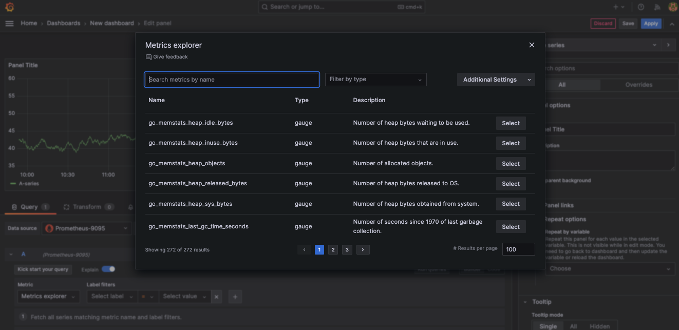

Click the Open book icon to open the Metrics explorer, where you can search for and filter all the metrics in your instance.
If you would like to explore your metrics in the query builder further, you can open the Metrics explorer by clicking the first option in the metric select component of the query builder.
The Metrics explorer displays all metrics in a paginated table list. The list shows the total number of metrics, as well as the name, type, and description for each metric. You can enter text into the search input to filter results. You can also filter by type.
The following options are included under the Additional Settings drop-down:
  • Include description in search: Toggle on to search by both name and description.
  • Include results with no metadata: Toggle on to include metrics that lack type or description metadata.
  • Disable text wrap: Toggle on to disable text wrapping.
  • Enable regex search: Toggle on to filter metric names by regex search, which uses an additional call on the Prometheus API.

Select the + Operations button to add operations to your query.
The query editor groups operations into the following sections:

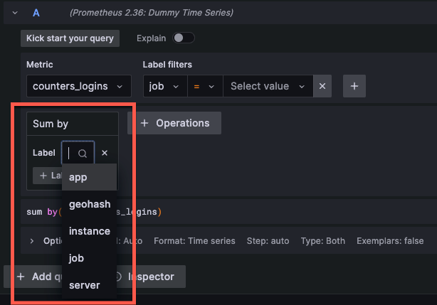

All operations have function parameters under the operation header. Click the operator to see a full list of supported functions. Some operations allow you to apply specific labels to functions.
Functions and labels
Some operations are only valid when used in a specific order. If you add an operation in a way that would create an invalid or illogical query, the query editor automatically places it in the correct position to maintain a valid query structure.

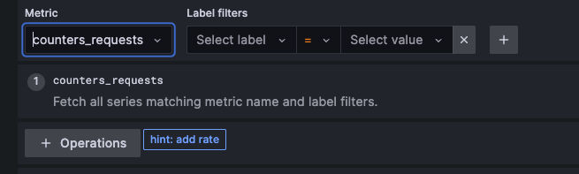

Hints
The query editor can detect which operations are most appropriate for certain selected metrics. When it does, it displays a hint next to the + Operations button.
To add the operation to your query, click the Hint.
Hint
Hint
When you are satisfied with your query, click Run query.

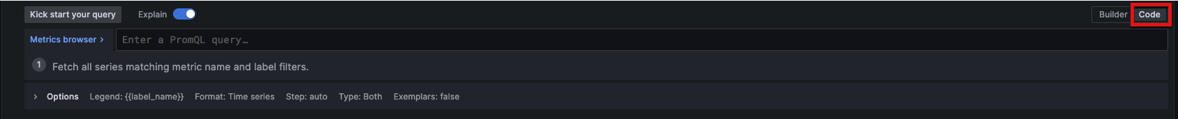

Code mode
Code mode is for the experienced Prometheus user with prior expertise in PromQL, Prometheus’ query language. The Code mode editor allows you to create queries just as you would in Prometheus. For more information about PromQL see Querying Prometheus.

You can write complex queries using the text editor with autocompletion features and syntax highlighting. Code mode’s autocomplete feature works automatically while typing. The query editor can autocomplete static functions, aggregations, keywords, and also dynamic items like metrics and labels. The autocompletion drop-down includes documentation for the suggested items where available.

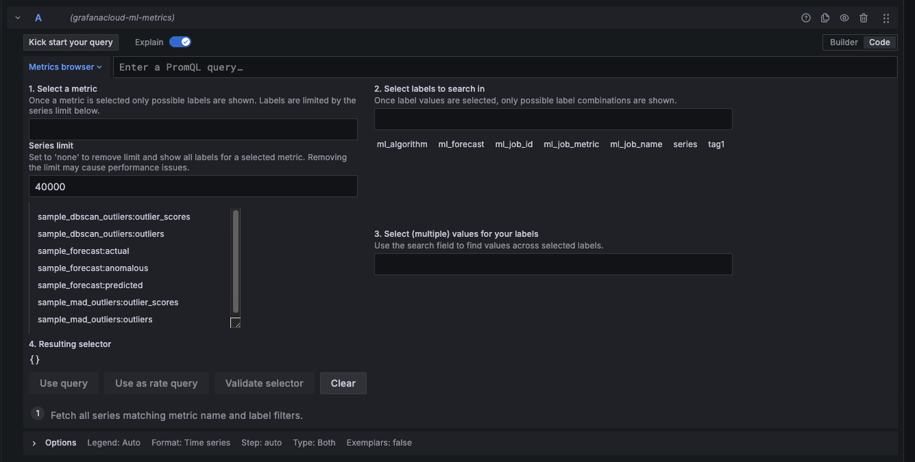

It also contains a Metrics browser to further help you write queries. To open the Metrics browser, click the arrow next to Metrics browser.
Metrics browser in Code mode
The Metrics browser locates metrics and selects relevant labels to help you build basic queries. When you click Metrics browser in Code mode, it displays all available metrics and labels. If supported by your Prometheus instance, each metric also displays its HELP and TYPE as a tooltip.
Prometheus query editor metrics browser
Metrics browser
When you select a metric under Step 1, the browser narrows down the available labels to show only the ones applicable to the metric. You can then select one or more labels shown in Step 2. Select one or more values in Step 3 for each label to tighten your query scope. In Step 4, you can select Use query to run the query, Use as rate query to add the rate operation to your query ($__rate_interval), Validate selector to verify the selector is valid and show the number of series found, or Clear to clear your selections and start over.

All lists in the Metrics browser include a search field to quickly filter metrics or labels by keyword. In the Values section, there’s a single search field that filters across all selected labels, making it easier to find matching values. For example, if you have labels like app, job, and job_name, only one of them might contain the value you’re looking for.
