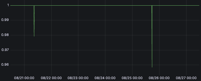

SLI query results must return a value between 0 and 1 for each evaluation period, where 1 represents 100% success and 0 represents 0% success.
Screenshot of the graph result of an SLI query
Grafana SLO continuously evaluates the SLI query. Each SLI is calculated over a specific time range defined in the query, typically $__interval or $__rate_interval.
