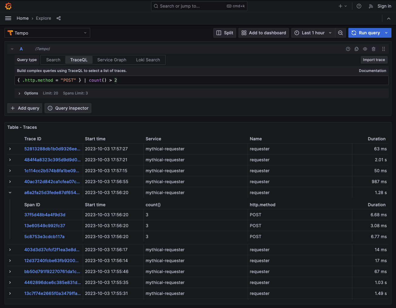

Construct a TraceQL query
In TraceQL, a query is an expression that’s evaluated on one trace at a time. The query is structured as a set of chained expressions called a pipeline. Each expression in the pipeline selects or discards spansets from being included in the results set. For example:
{ span.http.status_code >= 200 && span.http.status_code < 300 } | count() > 2In this example, the search reduces traces to those spans where:
http.status_codeis in the range of200to299and- the number of matching spans within a trace is greater than two.
Queries select sets of spans and filter them through a pipeline of aggregators and conditions. If, for a given trace, this pipeline produces a spanset then it’s included in the results of the query.

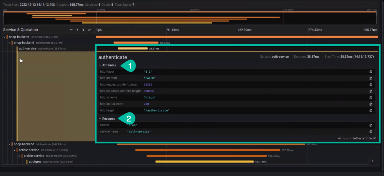

TraceQL supports these different attribute scopes: span attributes, resource attributes, event attributes, link attributes, and instrumentation scope attributes.
By expanding a span in the Grafana UI, you can see both its span attributes (1 in the screenshot) and resource attributes (2 in the screenshot).
Attribute fields are derived from the span and can be customized. Process and span attribute types are defined by the attribute itself, whereas intrinsic fields have a built-in type. You can refer to dynamic attributes (also known as tags) on the span or the span’s resource.

{ status=error } | select(span.http.status_code, span.http.url)Experimental TraceQL metrics
TraceQL metrics are experimental, but easy to get started with. Refer to the TraceQL metrics documentation for more information.
You can also use TraceQL metrics queries. For details, refer to TraceQL metrics queries.
