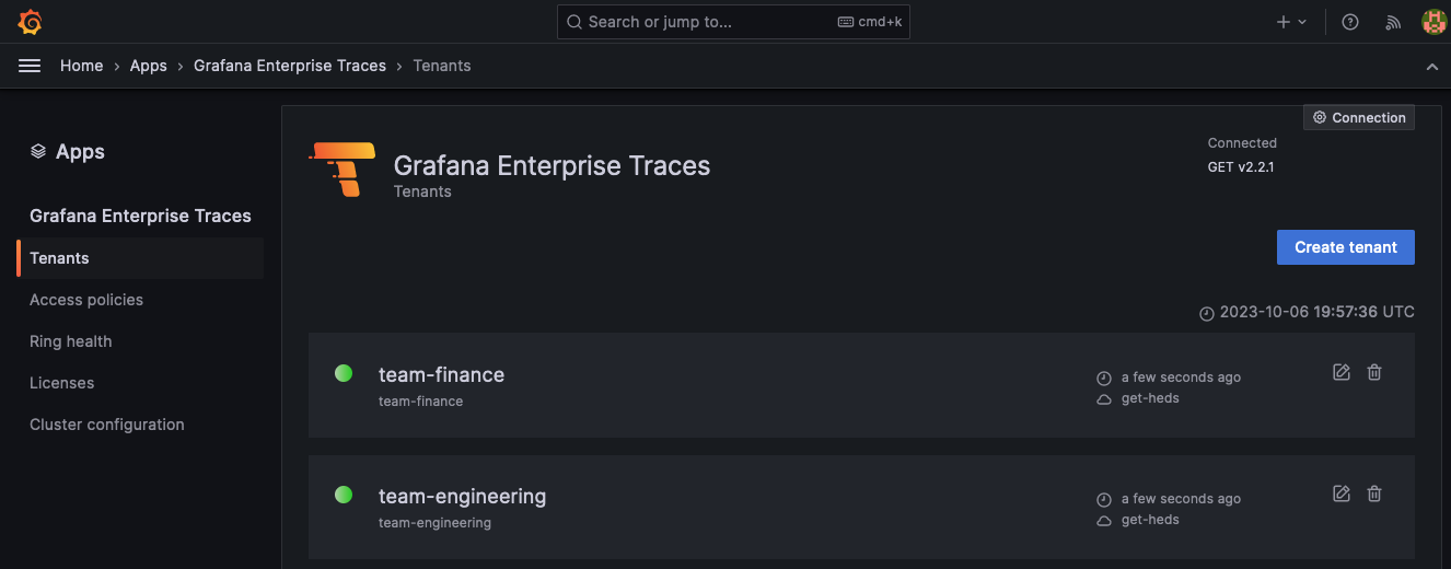

Create two new tenants
First, create two new tenants, team-engineering and team-finance, using the Grafana Enterprise Traces plugin for Grafana.
  1. Within Grafana, select Apps > Grafana Enterprise Traces.
  2. Select Tenants and then choose Create tenant.
  3. Name the first tenant team-engineering.
  4. Select Create tenant again and name the second tenant team-finance.
    Add two new tenants using the GET plugins

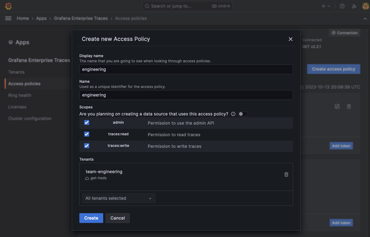

To allow queries to span both GET tenants, create a new access policy called leadership. For demonstration purposes, name these tenants team-engineering and team-finance. To create a raw access policy:
  1. Create a new access policy leadership.
  2. Enable the traces:read scope.
  3. Add the tenants team-engineering and team-finance. Alternatively, you can add the special tenant name * to create an access policy that has access to all tenants in the cluster.
  4. Select Create to add the new access policy. Create a new access policy for the tenants

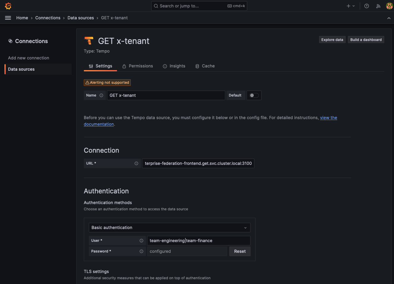

To set up a data source using the access policy:
  1. Create a new Tempo data source from the Grafana Connections menu and select Data sources. Select Add new data source.
  2. Search for Tempo and select Tempo data source.
  3. Under Connection field, select URL from the drop-down. Enter the URL of the frontend-federation Kubernetes service in your GET cluster. For example, where mycluster-get-install-tempo-enterprise-federation-frontend represents your GET namespace: http://mycluster-get-install-tempo-enterprise-federation-frontend.get.svc.cluster.local:3100.

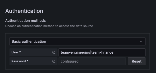

  4. From the Authentication section, enable Basic authentication.
    1. In the User field, enter: team-engineering|team-finance where all the names of the tenants that you want to query across are separated by the | pipe character.
    2. In the Password field, paste the token created in the token creation process for the tenant policy.
  5. At the bottom of the page, select Save to preserve your changes and Test to validate the configuration.
Authorization for cross-tenant configuration in the GET plugin
The test should respond with ‘Data source successfully connected’.

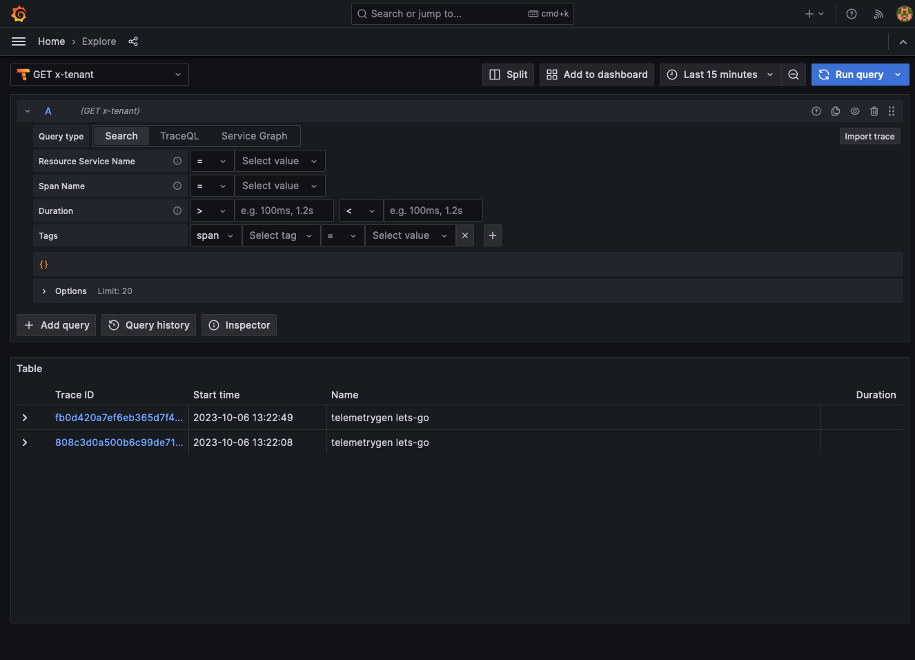

  1. Go to your Grafana instance and select the Explorer.
  2. Select your cross-tenant data source.
  3. Selection Query type > Search and select Run query. You should see two traces returned, one from each tenant.
TraceQL query showing results for cross-tenant search
