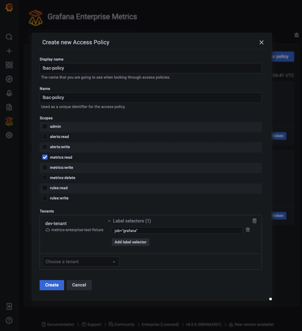

Setting up a label policy
Label policies are set when creating an access policy on a per tenant basis. This means each tenant associated with an access policy can have a unique label policy.
Create LBAC policy
Create LBAC policy

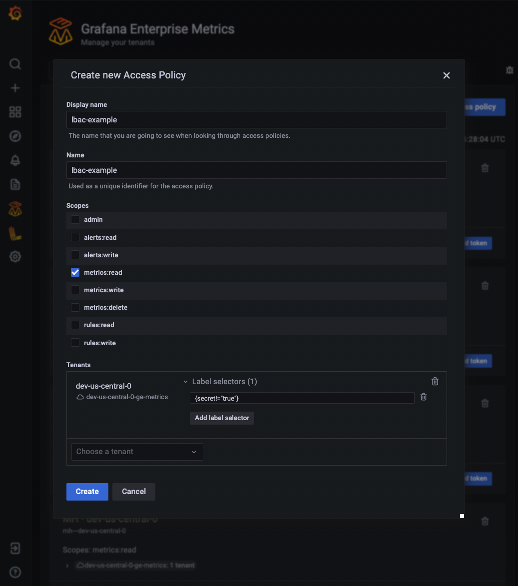

Exclude a label
One common use case for creating an LBAC policy is to exclude metrics with a specific label. For instance, a label policy that excludes all series with the label secret=true would be created by just adding a select with secret!="true" when creating an access policy. This can be seen in the image below:
Create exclude label
