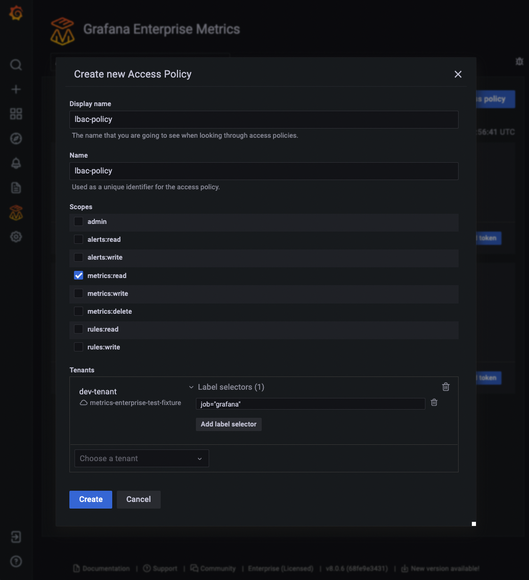

Setting up a label policy
Label policies are set when creating an access policy on a per tenant basis. This means each tenant associated with an access policy can have a unique label policy.

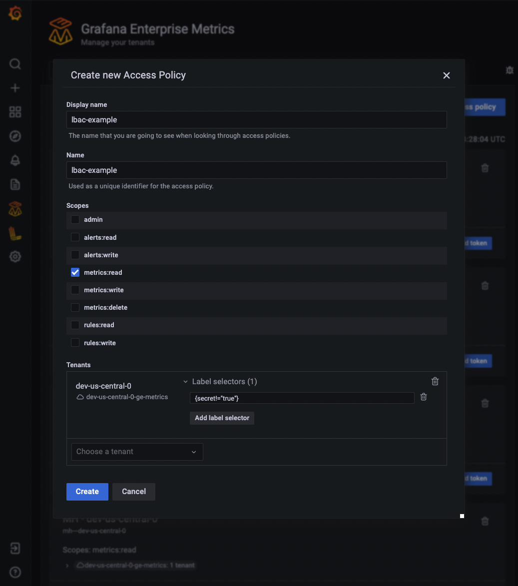

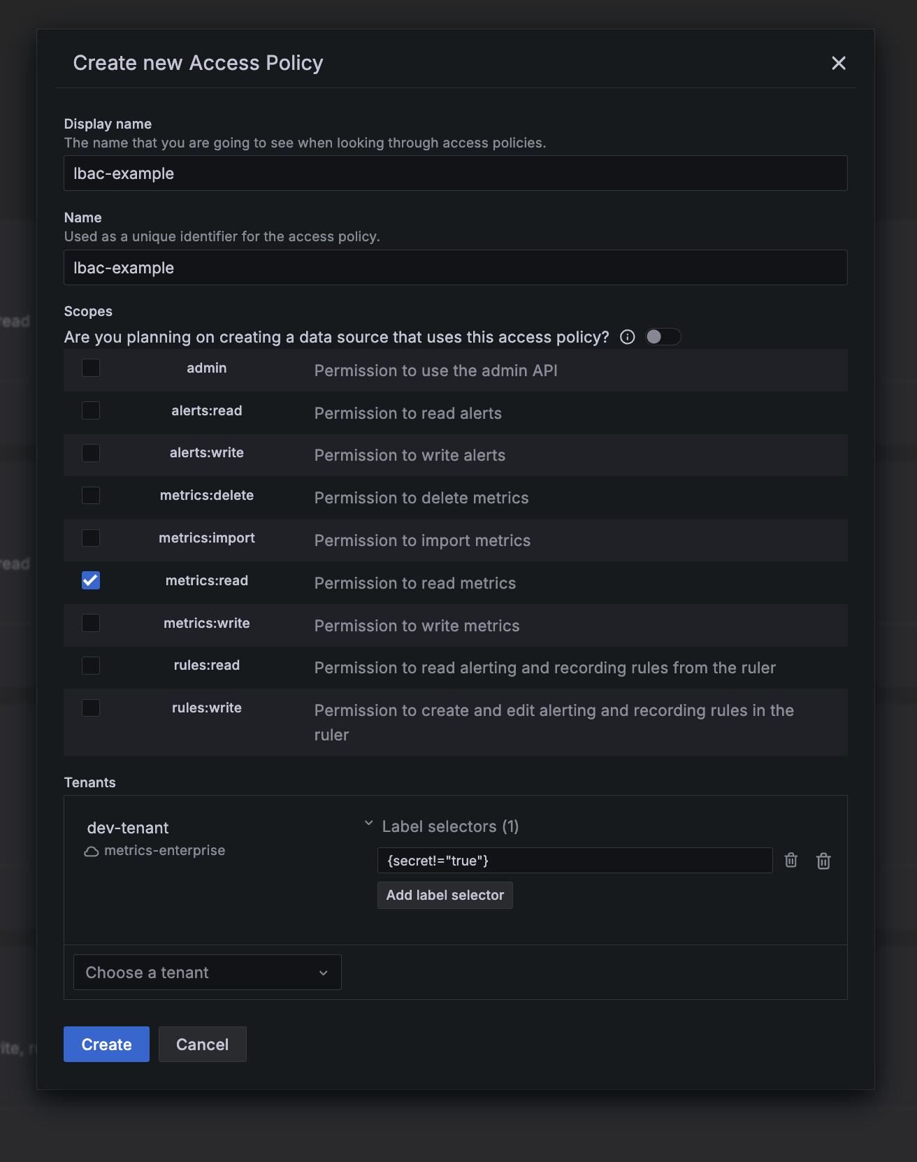

One common use case for creating an LBAC policy is to exclude metrics with a specific label. For instance, a label policy that excludes all series with the label secret=true
would be created by just adding a select with secret!="true"
when creating an access policy. This can be seen in the image below:

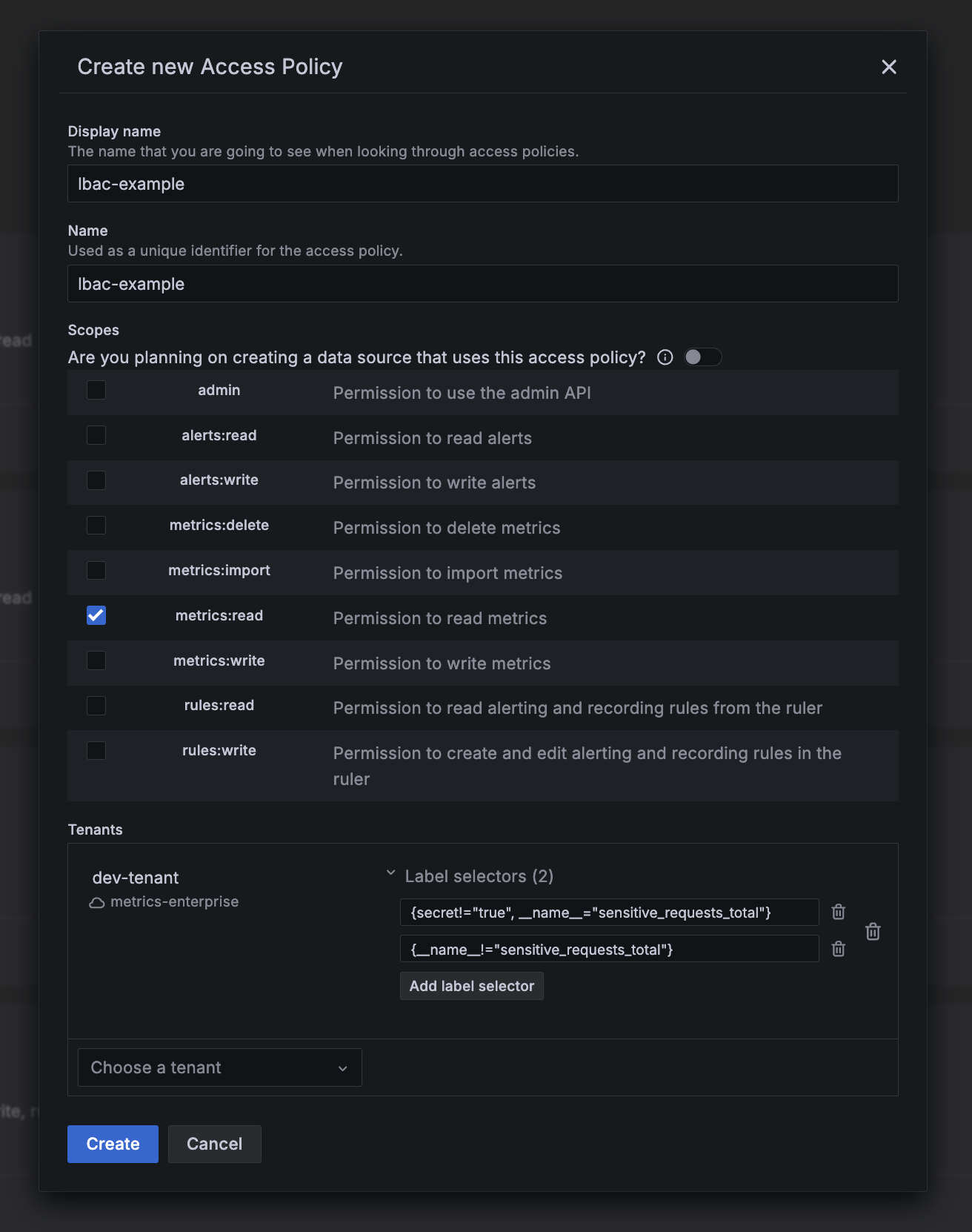

Expanding upon the previous example, lets say we wanted to create an access policy that only excludes metrics with the label secret=true
on the metric named sensitive_requests_total
. Since the name of a metric is actually just a label with the key __name__
, we can leverage the existing LBAC label selector syntax to enforce this:
You may notice above that two different selectors where added to enforce the policy. Specifically:
{secret!="true", __name__="sensitive_requests_total"}
and
{__name__!="sensitive_requests_total"}
The first selector will match when returning a series from the metrics sensitive_requests_total
and will ensure all of the returned series do not have the secret: true
label. However, when requesting a metric besides sensitive_requests_total
, the second label selector will match and return any data even if it has the secret: true
label.
