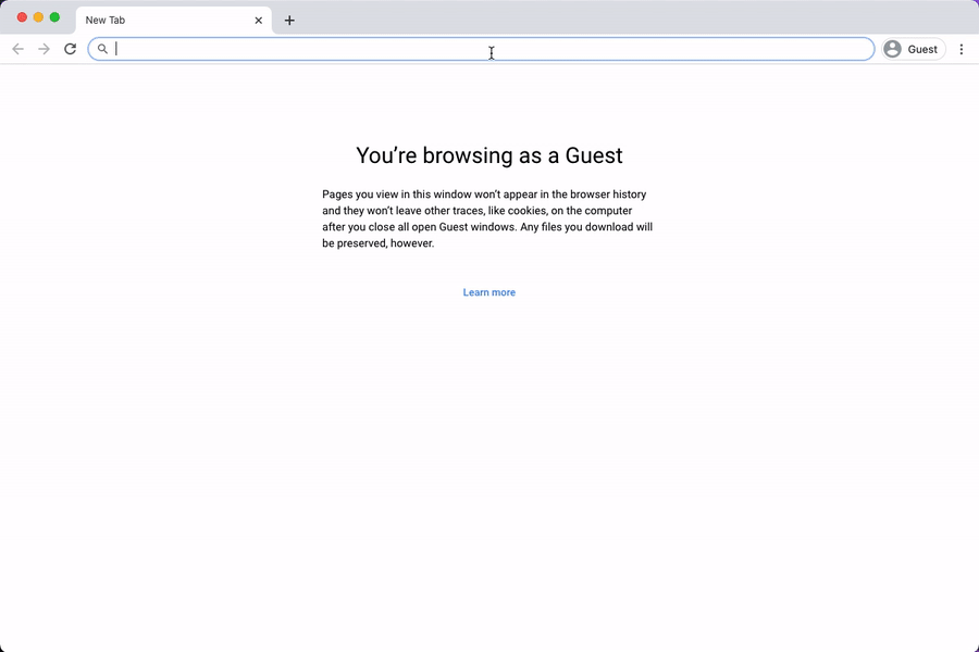

You can confirm you have setup Minio correctly by port-forwarding it and navigating to it in your browser:
kubectl port-forward service/minio 9000:9000
Then you can navigate to the minio admin console using your browser. The login credentials are the same as those set above, minio
and minio123
