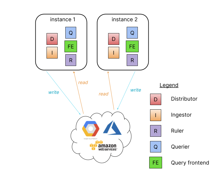

Monolithic mode
The simplest mode of operation sets -target=all. This is the default target, and it does not need to be specified. This is monolithic mode; it runs all of Loki’s microservice components inside a single process as a single binary or Docker image.
monolithic mode diagram
Monolithic mode is useful for getting started quickly to experiment with Loki, as well as for small read/write volumes of up to approximately 100GB per day.
Horizontally scale up a monolithic mode deployment to more instances by using a shared object store, and by configuring the memberlist_config section to share state between all instances.
High availability can be configured by running two Loki instances using memberlist_config configuration and a shared object store.
Route traffic to all the Loki instances in a round robin fashion.
Query parallelization is limited to the quantity of instances and the query parallelism defined.

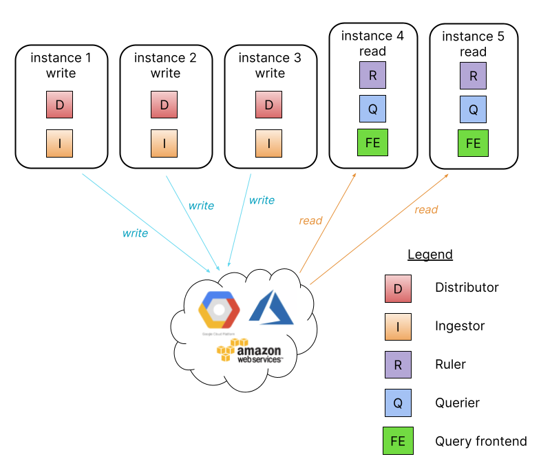

Simple scalable deployment mode
If your volume of logs exceeds a few hundred GB a day, or if you would like to separate read and write concerns, Loki provides the simple scalable deployment mode. This deployment mode can scale to several TBs of logs per day and more. Consider the microservices mode approach for very large Loki installations.
simple scalable deployment mode diagram
In this mode the component microservices of Loki are bundled into two targets: -target=read and -target=write. The BoltDB compactor service will run as part of the read target.
There are advantages to separating the read and write paths:
  • higher availability of write path by providing dedicated nodes
  • separately scalable read path to add/remove query performance on demand
The simple scalable deployment mode requires a load balancer in front of Loki, which directs /loki/api/v1/push traffic to the write nodes. All other requests go to the read nodes. Traffic should be sent in a round robin fashion.
The simple scalable deployment of Loki can scale to several TBs of logs per day and more.

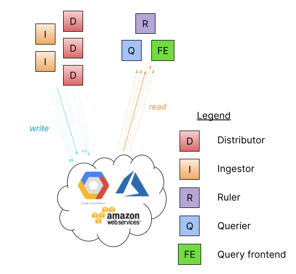

Microservices mode
The microservices deployment mode instantiates components of Loki as distinct processes. Each process is invoked specifying its target:
  • ingester
  • distributor
  • query-frontend
  • query-scheduler
  • querier
  • index-gateway
  • ruler
  • compactor
microservices mode diagram
Running components as individual microservices allows scaling up by increasing the quantity of microservices. The customized cluster has better observability of the individual components. Microservices mode deployments are the most efficient Loki installations. However, they are also the most complex to set up and maintain.
Microservices mode is recommended for very large Loki clusters or for clusters that require more control over scaling and cluster operations.
Microservices mode works best with Kubernetes deployments. There are Jsonnet and distributed Helm chart installations.
