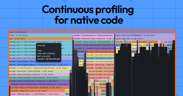

A quick look into Profiles Drilldown view shows us the data is flowing:
A colorful flame graph displaying performance data, with various labeled blocks in different colors and a tooltip showing detailed metrics.
Note the demangled C++ names, thanks to built-in demangling support in Alloy on Linux.

Using the DrilldownProfiles screen again, we can filter for duckdb executable by labels, and see the distribution of own/nested CPU time for functions:
A list of executables with associated time durations and percentages, displayed in a dark-themed interface.
Further context is provided by the flame graph view. We can limit it to ExecutorTask::Execute function here for better visibility:
A flame graph visualizing time distribution of various tasks and processes over a total of 3.97 hours.
Thanks to stack walking and demangling, we see a clear list of functions that use the most CPU in our scenario. If we were to attempt to optimize the runtime of the TPC-H benchmark in DuckDB, our first candidates for optimization would be:
