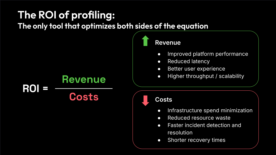

One reason Perry thinks profiling is unique compared to the other signals "is that it's the only tool that really directly optimizes both sides of the ROI equation."
The information you get from flame graphs can help you increase throughput, improve user experience, and reduce latency—all of which can increase revenues derived by your application, Perry said.
The benefits on the cost side, meanwhile, are unique to profiling, Perry said, because "you're able to basically see where your costs are going." It's commonly used for memory and CPU, but it also can be used to see how much any resource is costing, which helps optimize and minimize those costs.
"A lot of times—as we've seen with many people using this," Perry added, "it tends to be some easy, low-hanging fruits of things that you didn't realize were using as much resources as they are."

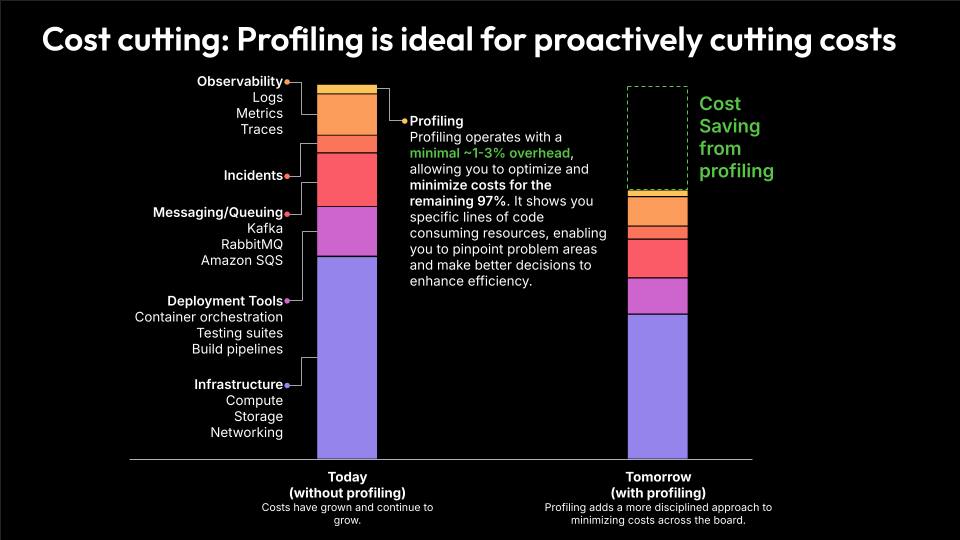

According to Perry, the number one question the Grafana Labs team hears when people try using Pyroscope for the first time is, "What's the overhead and how much is it going to cost me?"
The answer: "What we usually say—and what is true about it—is that it is very low overhead because we're using sampling profilers," he said.
For people who had problems with how much overhead profiling added to their application in the past, Perry said it's likely they were using a different kind of profiler. "This one is just simply sampling the stack trace a hundred times per second to be able to understand what's going on in your application, and then it's sending that off to whatever backend."
It happens from a separate process, unlike what goes on with metrics, logs, traces, or other signals, where a code is usually inserted into the path of an application. By default, that requires much more overhead for the application than profiling ever would, he explained.
Perry noted that one of the most common things people discover when they add profiling for the first time and start using Pyroscope is that they were, perhaps, accidentally spending 10% of their CPU logging something useless that shouldn't have been logged, or they had too many trace spans, which were causing issues.
Having that visibility into what your application is actually spending its resources on is, in Perry's admittedly biased opinion, "always worth the 1% overhead to understand what's going on with the other 99% of your resources that you're spending."
As the bar chart above illustrates, observability is just a sliver of the total savings profiling can deliver. Messaging and queuing systems are one of the most popular areas where profiling can save money. "If you ever have overflowing cues, Kafka consumers, sidekick workers—whatever your queuing system is—profiling is always a very, very good tool because it's notoriously an area where you can just send something to your asynchronous land and just forget about it." That can lead to a lot of bloat and problems, "and profiling will help you fix that," Perry said.
