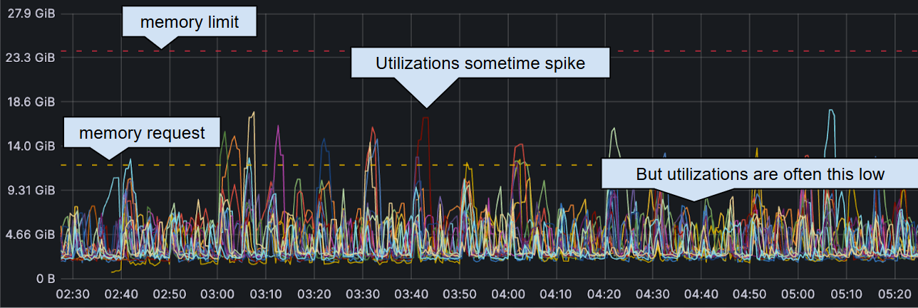

In Mimir, the querier is the component that evaluates queries. At Grafana Labs, we run a number of large Mimir clusters internally. We noticed that the queriers often consume varying amounts of memory because different queries will load a different number of samples. We have to set sufficient memory requests and limits to minimize the probability that a querier pod gets killed by the Kubernetes scheduler when the actual memory utilization exceeds the memory limit.
%3Aquality(100)%2F&w=3840&q=75)
The visualization above shows the graph of querier memory utilization compared with the memory request and memory limit. While setting the memory limit and request on the high side can work, it is inefficient if the querier component is not utilizing the memory requested. Despite plenty of memory utilization spikes here and there, at different times, memory utilization can also go very low below the memory request. Grafana Mimir operators are paying for the memory request at the dashed yellow line, but the actual utilization is often below that.

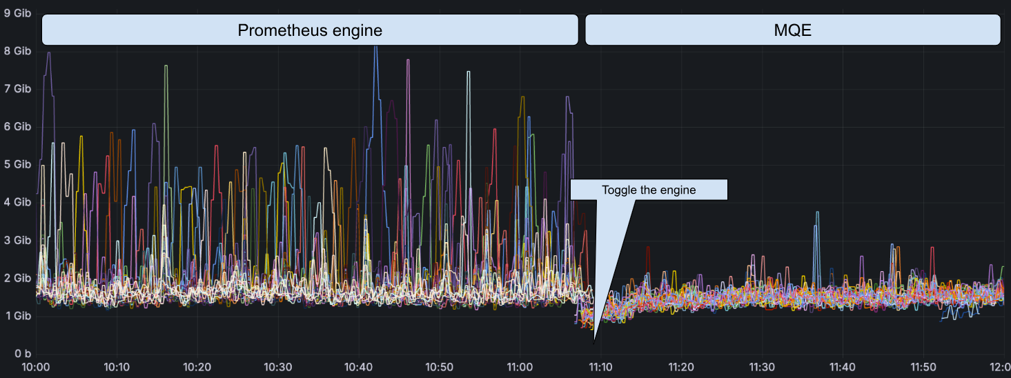

The graph above shows the querier memory consumption and how it looks as we toggle the engine from Prometheus to MQE after 11:00, resulting in a significant drop in memory consumption. MQE has proven that it reduces querier memory fluctuations.

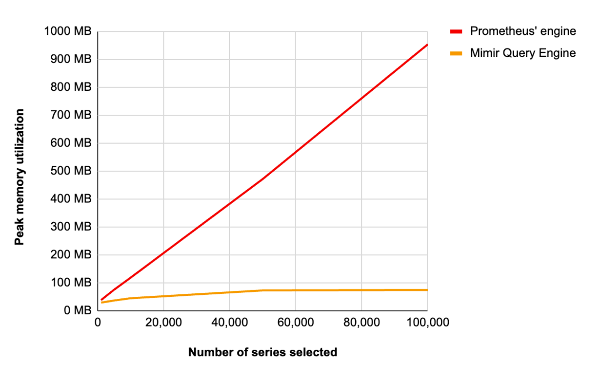

On top of this, the peak memory utilization of the engine scales much better with increasing numbers of input series. The graph below shows the peak memory consumption when evaluating sum by (group) (metric{...}) with different numbers of input series:

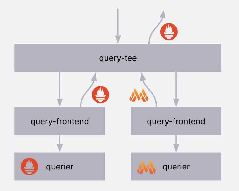

Second, we ran a parallel query path in Grafana Cloud’s staging environment using Mimir query-tee to compare the results from real, live queries. This helped us catch possible correctness issues and edge cases that might be missed from the unit tests alone.
The diagram above shows how the parallel query path works. The same query comes to query-tee which is fanned out to a Prometheus read path and MQE read path. Each query-frontend will forward the request downstream and return each result back to query-tee, which will perform a comparison, alerting us to discrepancies between the two engines.
