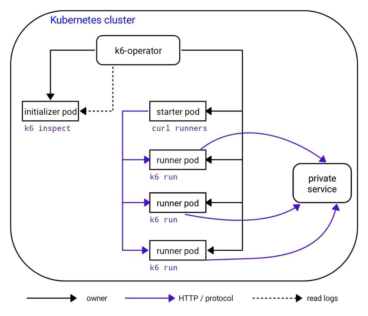

TestRun: Declaratively runs a k6 test in Kubernetes. As of now, the TestRun CRD (depicted in the diagram below) is the simplest way to run a distributed k6 test with OSS tooling, assuming you have a Kubernetes cluster.
A diagram depicting the workflow of a TestRun CRD, showing a Kubernetes cluster with k6 Operator, an initializer pod, starter pod, runner pods, and private service with HTTP and log connections.

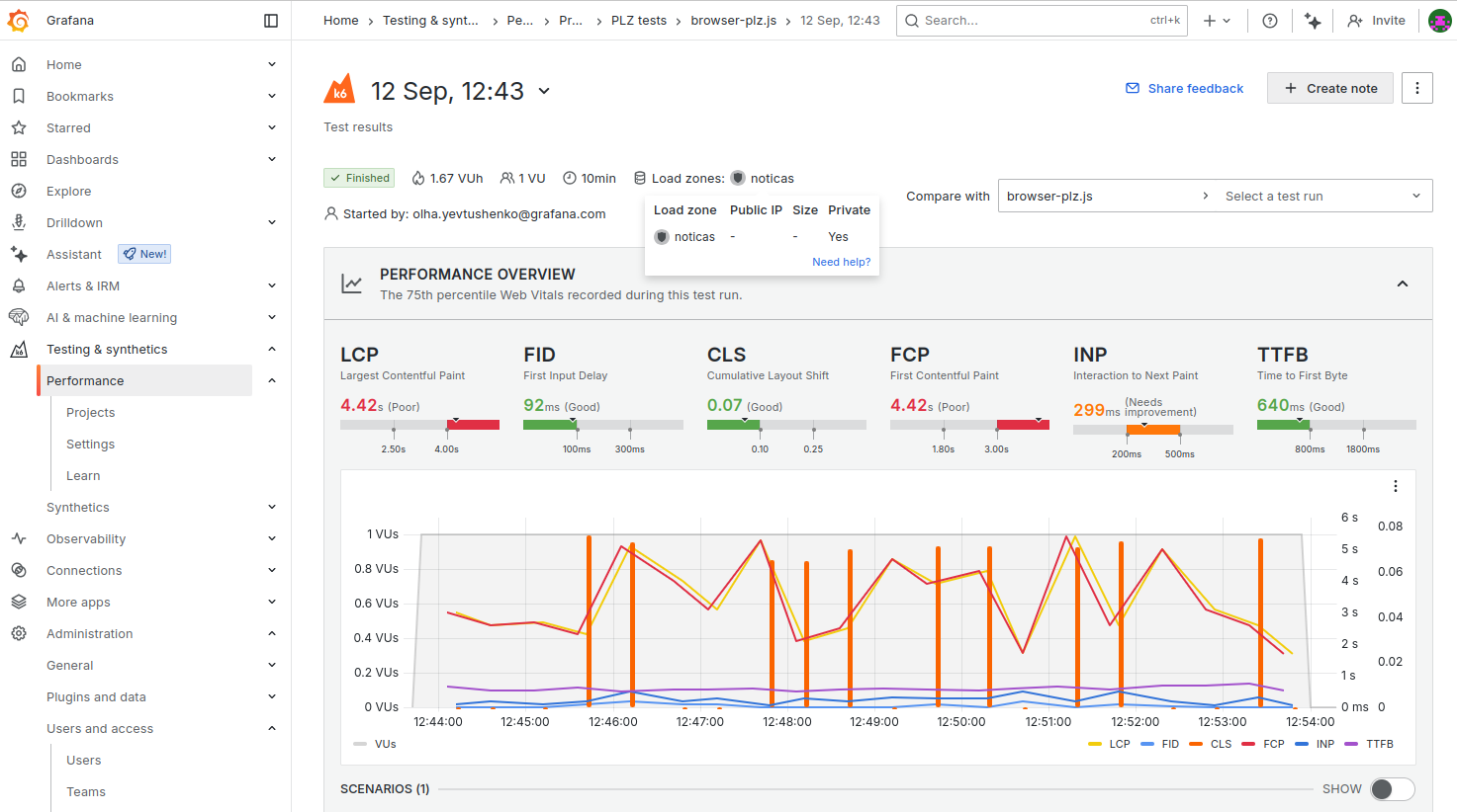

PrivateLoadZone: Registers a Private Load Zone (PLZ) so that Grafana Cloud k6 — the fully managed performance testing platform powered by k6 OSS — can run tests inside your Kubernetes cluster. This allows you to perform tests with a simple k6 cloud run command rather than create a TestRun Kubernetes resource manually.
A Grafana Cloud k6 dashboard displaying web performance metrics: LCP, FID, CLS, FCP, INP, TTFB with graphs and scores.
