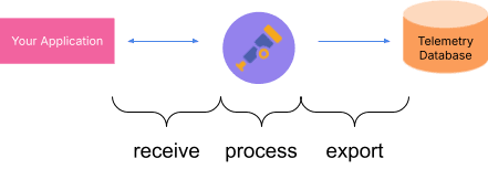

By adding a collector or agent between your application and storage, this component can then pull or receive data, enrich it, and send it off to the database. It also completely decouples the application from the storage backend, allowing for seamless transition or reconfiguration without downtime.

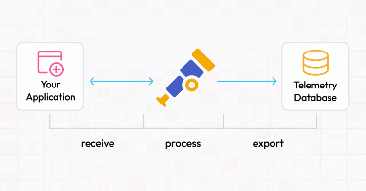

Collector activities can be summarized as receive → process → export.
At the receiving end, the collector specifies on which endpoints to listen or which applications to scrape, combining the pull and push approach. Data is handed off to the processing stage, where it can be further refined, converted, or aggregated. After that, data is packaged and sent off using an exporter.

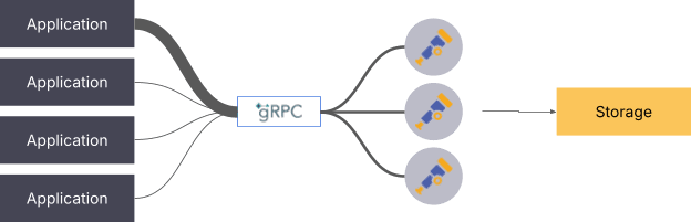

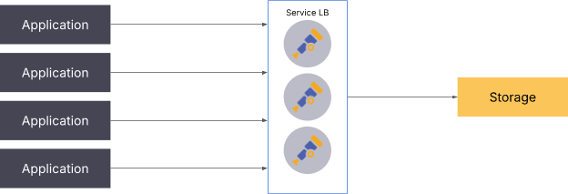

When utilizing push-based signals, the simplest approach to scaling is to load balance the requests made to the collector. Keep in mind that this architecture is still not perfect, as distributing the load on the service layer can still lead to a single producer overloading a specific collector.
The solution to this issue is to either deploy a gRPC-aware load balancer or add another collector utilizing the load-balancing exporter.

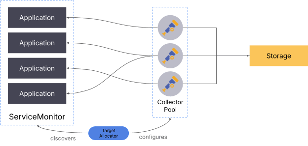

When scaling up pull metrics, the collector instances need to be told which targets to scrape. In the Kubernetes ecosystem, the target allocator takes care of this. It’s an additional component that discovers endpoints and distributes them to a set of collectors.

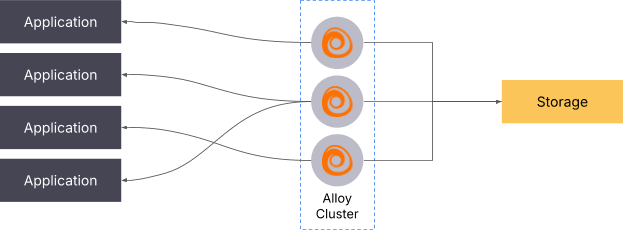

Using Grafana Alloy, it is possible to scale pull-based metrics without the target allocator. Alloy supports clustering multiple collectors together, which then split the targets dynamically. This is also usable outside of Kubernetes.
You can learn more about this in the clustering documentation.
