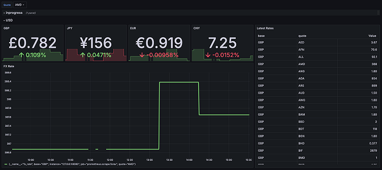

 - Visualize the changes in forex rates

/metricsendpoint exposed by the forex Prometheus exporter. Here I have used the remote write configuration from step 4 and added a scrape target, which is our running forex exporter container. Once you have edited the configuration file, you need to restart Alloy for the configuration to take effect. - You should now be seeing a metric in Grafana Cloud. Verify that it’s working by heading to your Grafana Cloud instance and going to Explore — you should see a metric called
fx_rate - Now you can run queries, make dashboards, and set up alerts based on the forex rate. Below I’ll show some examples for your inspiration
