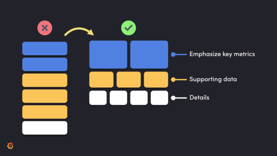

- Size: This one is fairly straightforward: the bigger the size of the component, the greater the perception of importance. For example, you could emphasize key metrics in a large stat panel, and then place supporting data and other details beneath it in smaller panels.

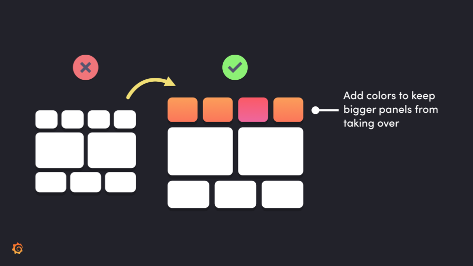

- Color: Our eyes are drawn to bright, saturated colors. If the color of an object is visually distinct from its background, the viewer will likely notice it first. So, if you’re forced to use larger panels in the middle of your dashboard — for a geomap, for example — but want to emphasize information in the top panels, you could use color to direct a user’s attention back to the top.
