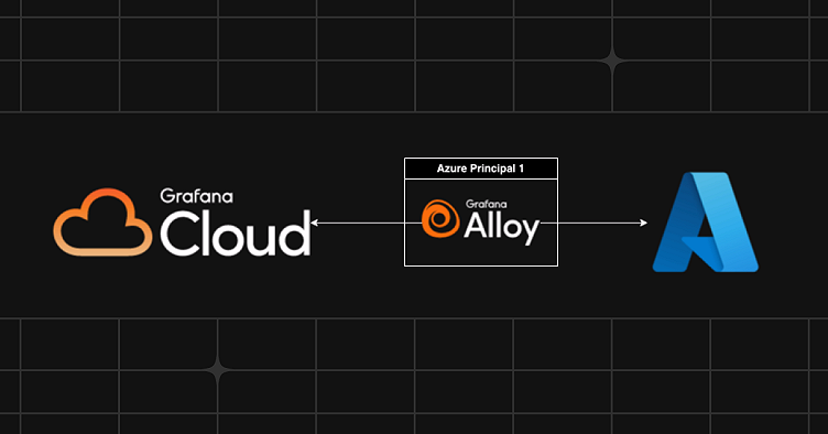

Azure makes various APIs available for gathering metrics. Before subscription-level metrics, Alloy collected metrics from Azure resource-by-resource, with this workflow:
This approach had a few downsides:
- The amount of resources in your Azure subscription dramatically increased the amount of time it took to collect the metric data.
 - The rate limit on Azure’s Monitor API is not very high, which made it very easy to encounter errors that block you from collecting all your metric data.
There were workarounds to these problems that involved running multiple Alloy deployments that used different service principals, each of which got its own resource limit. It would end up looking something like this:
As a result, you had to manage many independent Alloy deployments that cannot take advantage of Alloy clustering.
Clustering enables a fleet of Alloy deployments to work together to ensure high availability. This creates a horizontally scalable system with minimal resource and operational overhead, ensuring your mission critical Azure metrics will always be available for you.
Using the subscription-level metrics feature, you can collect data from all relevant resources in a region with a single API call. This lets you run a single or clustered Alloy deployment and potentially reduce the amount of API calls from thousands down to less than 100.
