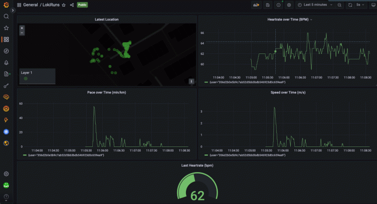

Creating a Grafana dashboard
The only thing left is setting up a nice dashboard where you can monitor your running metrics! Assuming you’re Grafana experts, we’re keeping things simple here and just putting a couple of panels together with metrics obtained from the logs.
Here is one we use for plotting the heart rate by user over time:
avg_over_time ({app="lokiruns"} | logfmt | line_format{{.message}}| json  | unwrap heartrate [2s]) by (user)
Basically, what you need to do is:
- Select the right stream:
{app="lokiruns"} - Get rid of the non-json parts (e.g.
timestamp="2022-07-30 10:36:39 +0000 UTC" kind=log message=")by:| logfmt | line_format{{.message}} - Parse the json message with the sensor data:
| json - Unwrap the value (so you can use it in an aggregate function:
| unwrap heartrate - Average the values over time by user:
avg_over_time (... [2s]) by (user)
You’ll get something like the dashboard below. Here, we’re monitoring the last location, heart rate over time, pace over time, speed over time, and the last heart rate.
Seeing all of these metrics is helpful when analyzing your run and current fitness status. With Grafana 9.1 you can even make your dashboard public if you want to share your latest run with your trainer or friends and family.
