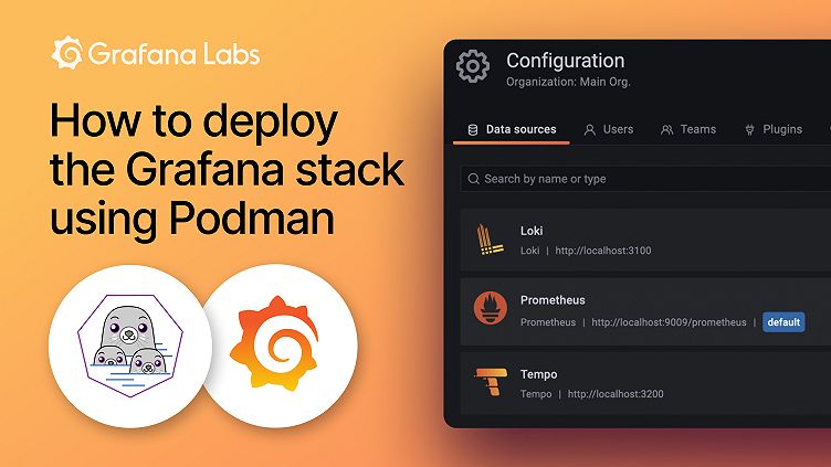

Next up, we want to add our metrics, logs, and traces stores by adding them as data sources. You can do this by clicking the gear icon in the lower left hand corner once logged into Grafana and clicking Add data source. When configuring the Prometheus, Grafana Loki, and Grafana Tempo data sources, you will want to configure them with the ports we exposed and the end result will look something like this.
And that’s all! You can see exactly how simple it is to stand up the entire Grafana stack using containers via the monolithic deployment option, whether this be for local testing/development purposes or proof of concepts. With the Grafana stack fully up and operational, we are ready to start sending these backends our metrics, logs, and trace data from our systems and applications by writing to them directly or using something like the Grafana Agent.
