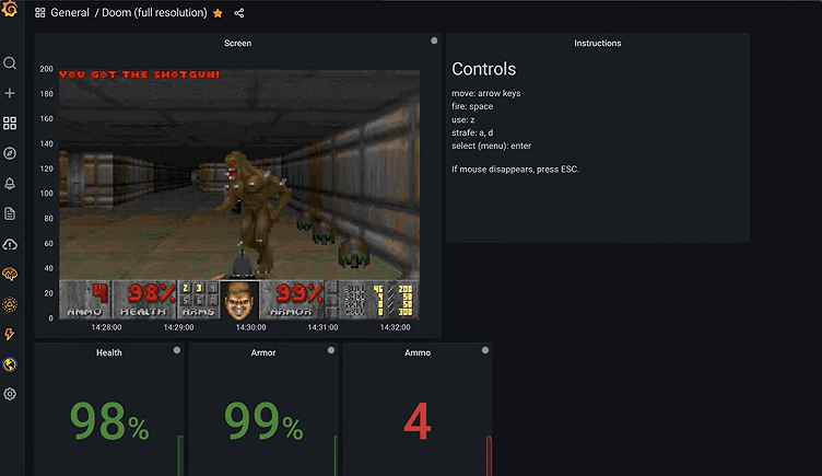

MAP08: Final output
You can now try “Doomfana” at full resolution or half resolution. In the half resolution mode (100x160) alone, there are 256 active time series (one per color) and 16k data points rendered at ~30 frames per second.
There’s supposed to be a video here, but for some reason there isn’t. Either we entered the id wrong (oops!), or Vimeo is down. If it’s the latter, we’d expect they’ll be back up and running soon. In the meantime, check out our blog!
Above: Doom is running inside Grafana’s main graph visualization, using 256 active time series and streaming data visualized as dots.
