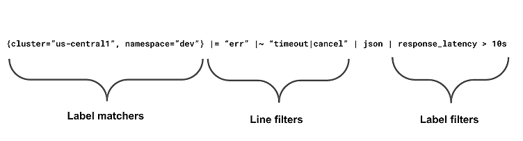

In Loki there are three types of filters that you can use:
Label matchers
Label matchers are your first line of defense, the best way to drastically reduce the amount of logs (e.g., from 100TB to 1TB) you’re searching for. Of course this means you need to have good label hygiene with your agent: Basically, labels should define your workload (cluster, namespace, and container are good ones to stick to) so that you can slice the data on multiple different dimensions. For example:

Line filters
Line filters are your second best friend, as they are super fast. They allow you to filter logs that contain (|=) or do not contain (!=) strings, and you can also use RE2 regexes to match (|~) or not match (!~) a pattern. It’s not mandatory, but you should have them right after label matchers.

Label filters
Label filters provide more complex comparisons (duration, numerical, etc.), but they usually require extracting labels first and then converting the label value into another type. Meaning they usually are the slowest, so you should use them last.

These three filters (label matchers, line filters, and label filters) are like a pipeline that will process your logs step by step. You should try to reduce as much as possible at each step, since each subsequent step is more likely to be slower to execute for each line.
