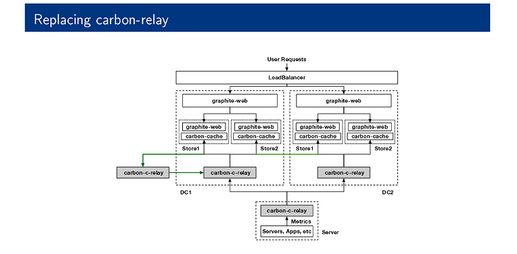

Rewriting the relay
To solve the problem of having a single point of failure, a Graphite team at Booking.com rewrote the relay in C. “We decided to place a relay as close as possible to the producers of metrics, so every server has a small relay that knows about several bigger endpoints—basically several relays in each data center,” he said. The central relay knows about the storages and how to balance the metrics, and has rules to get rid of some things or to rewrite them into something else.
The relay provides redundancy and speed. “It can consume more than a million data points per second using only two CPU cores, which was, well, a really desirable feature for us at that moment,” Smirnov said.
Using the Graphite line protocol, the relay reads metrics, validates them, and decides where to send them. Importantly, it can buffer the data for some time if there’s a network or node failure, and there is no data loss in most cases of outages.
