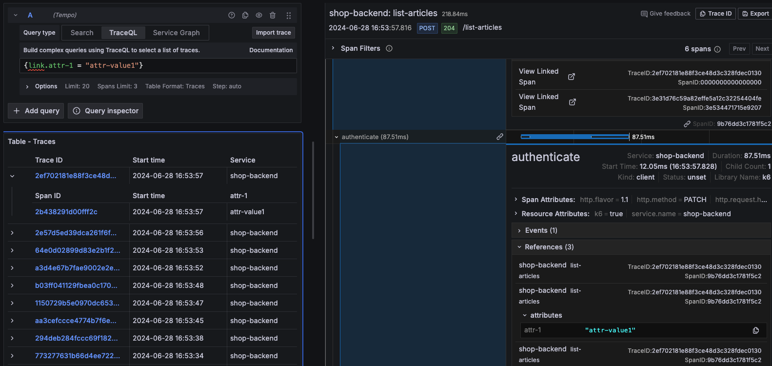

If you’ve instrumented your traces for span links, you can use the link scope to search for an attribute within a span link. A span link associates one span with one or more other spans. [PRs 3814, 3741]
For more information on span links, refer to the Span Links documentation in the Open Telemetry project.
You can search for an attribute in your link:
{ link.opentracing.ref_type = "child_of" }

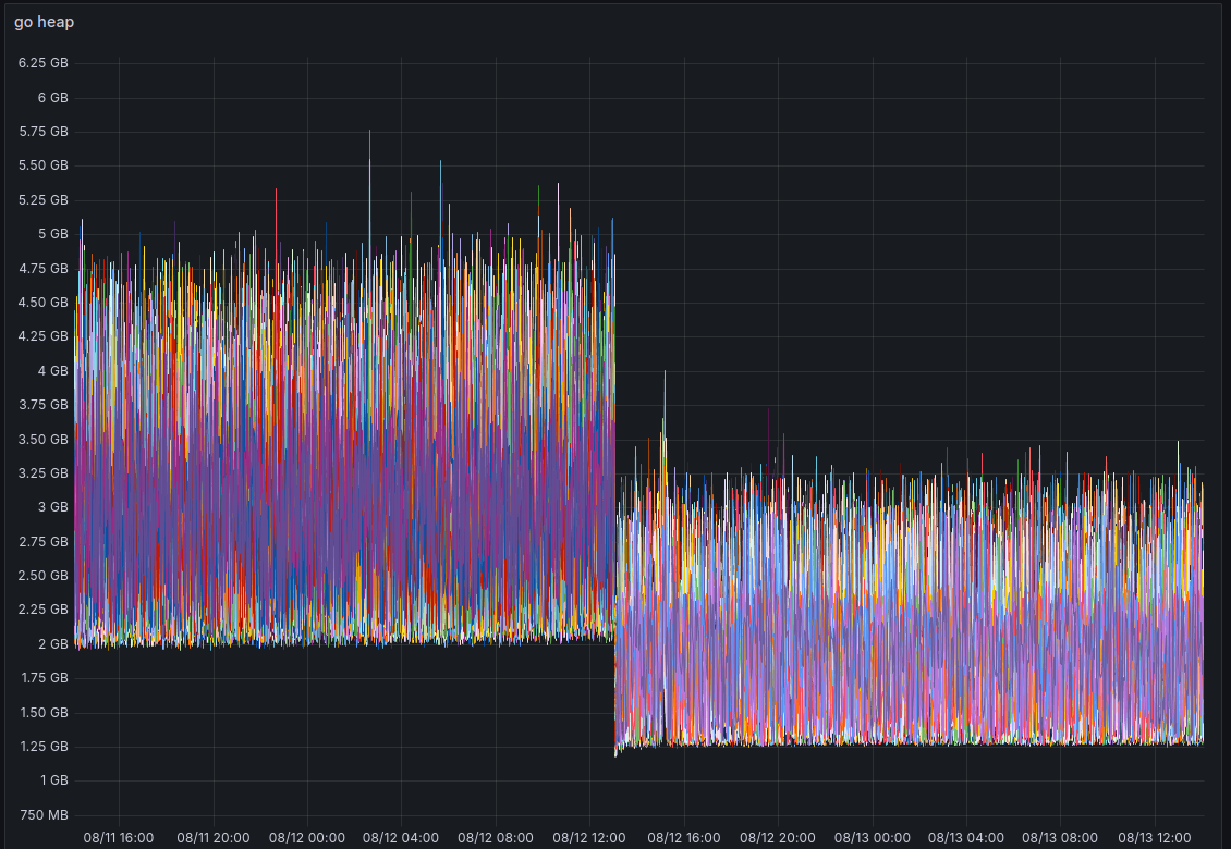

Performance improvements
One of our major improvements in Tempo 2.6 is the reduction of memory usage due to polling improvements. [PRs 3950, 3951, 3952
This improvement is a result of some of these changes:
- Add data quality metric to measure traces without a root [PR 3812]
- Reduce memory consumption of query-frontend [PR 3888]
- Reduce allocs of caching middleware [PR 3976]
- Reduce allocs building queriers sharded requests [PR 3932]
- Improve trace id lookup from Tempo Vulture by selecting a date range [PR 3874]
