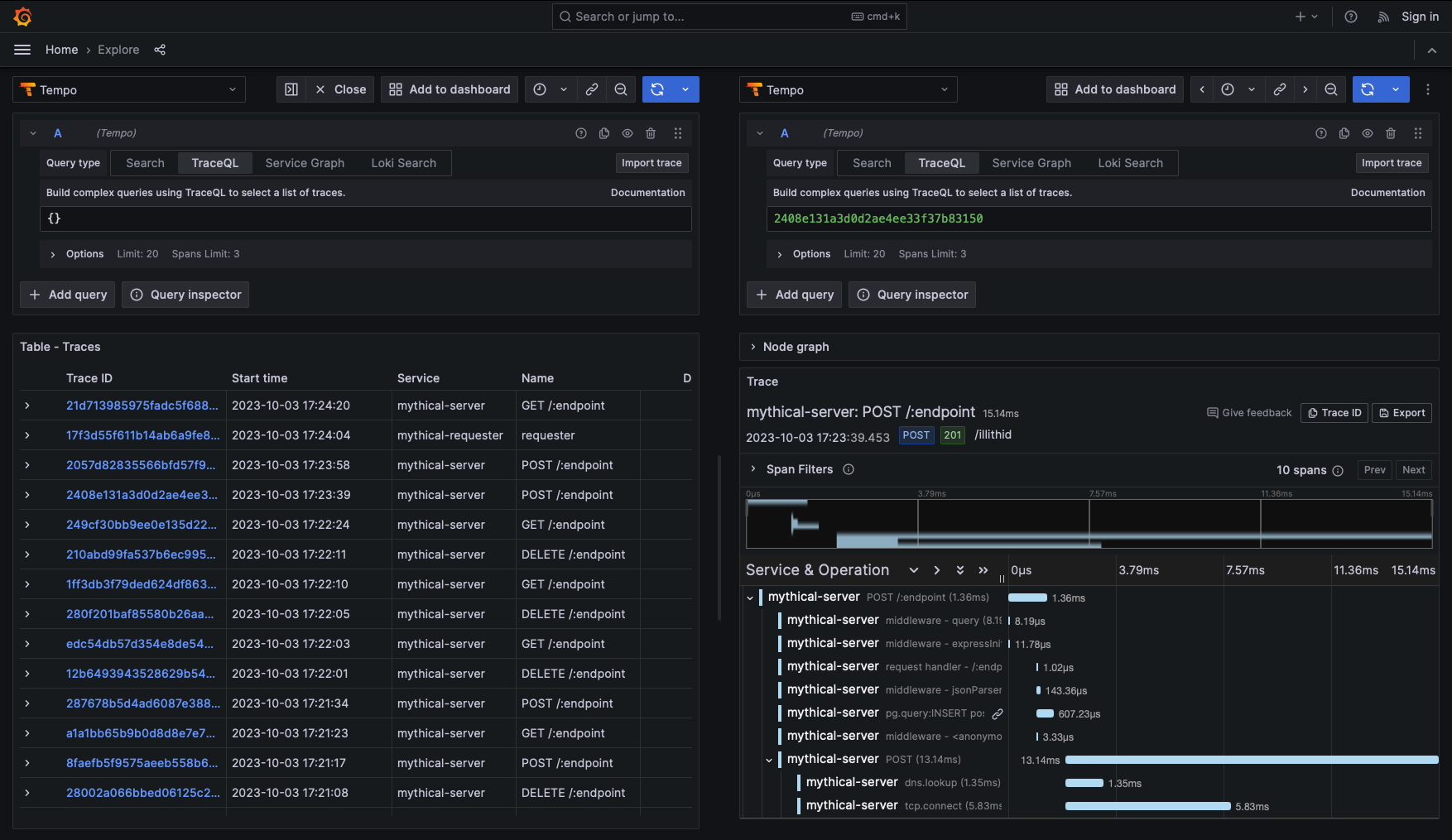

TraceQL query editor in Grafana
To make it easier to run and visualize the results of TraceQL queries, we’ve added a TraceQL query editor to Grafana’s Tempo data source. The editor is available in Grafana’s Explore interface starting in Grafana version 9.3.2.
Query editor showing span results

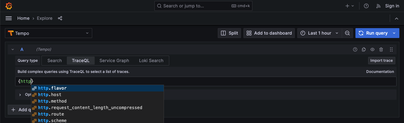

The query editor helps you learn TraceQL by offering autocomplete.
Query editor showing the auto-complete feature
