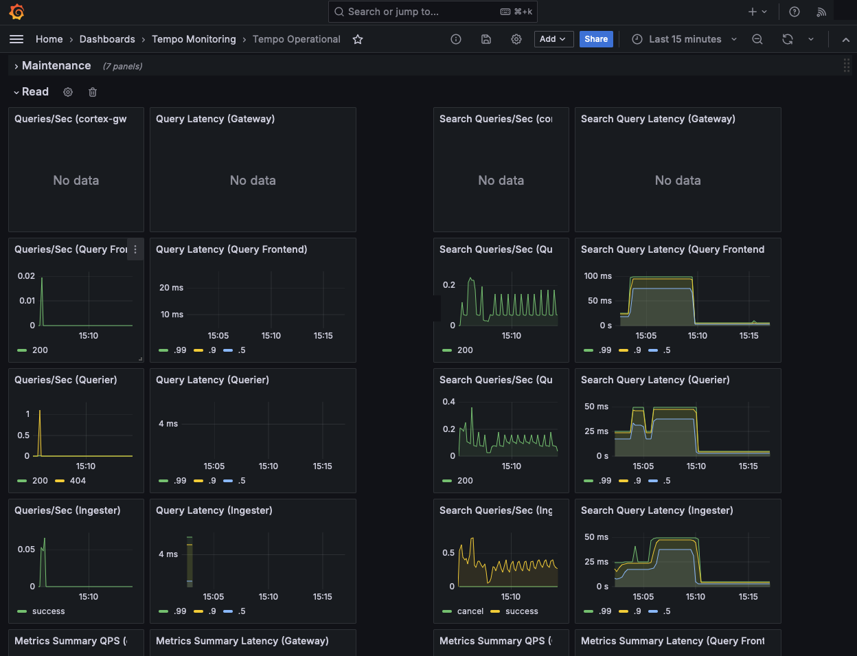

The ‘Tempo Operational’ dashboard shows read (query) information:
Tempo Operational dashboard
