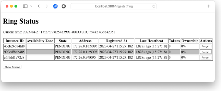

The low-level ring data for ingesters can be viewed by browsing to the /ingester/ring URL on a distributor. It looks like this:
Ring status with default port
By default, gRPC traffic uses port 9095, but this can be changed by customizing the grpc_listen_port for each pod that needs it.

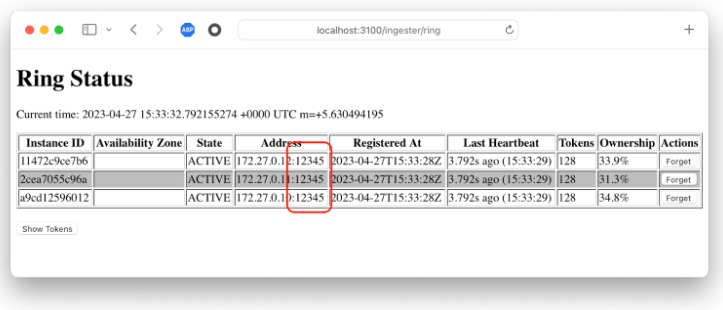

The ring contents reflect the new port:
