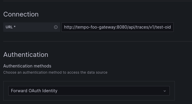

Set the data source URL parameter to http://<HOST>:<PORT>/api/traces/v1/{tenant}/tempo/, where {tenant} is the name of the tenant.
To use it as a data source, set the Authentication Method to Forward Oauth Identify using the same clientID and clientSecret for gateway and for the OAuth configuration. This will forward the access_token to the gateway so it can authenticate the client.
Tempo data source configured for the gateway forwarding OAuth access token

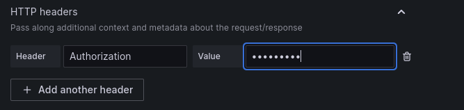

If you prefer to set the Bearer token directly and not use the Forward Oauth Identify, you can add it to the “Authorization” Header.
Tempo data source configured for the gateway using Bearer token
