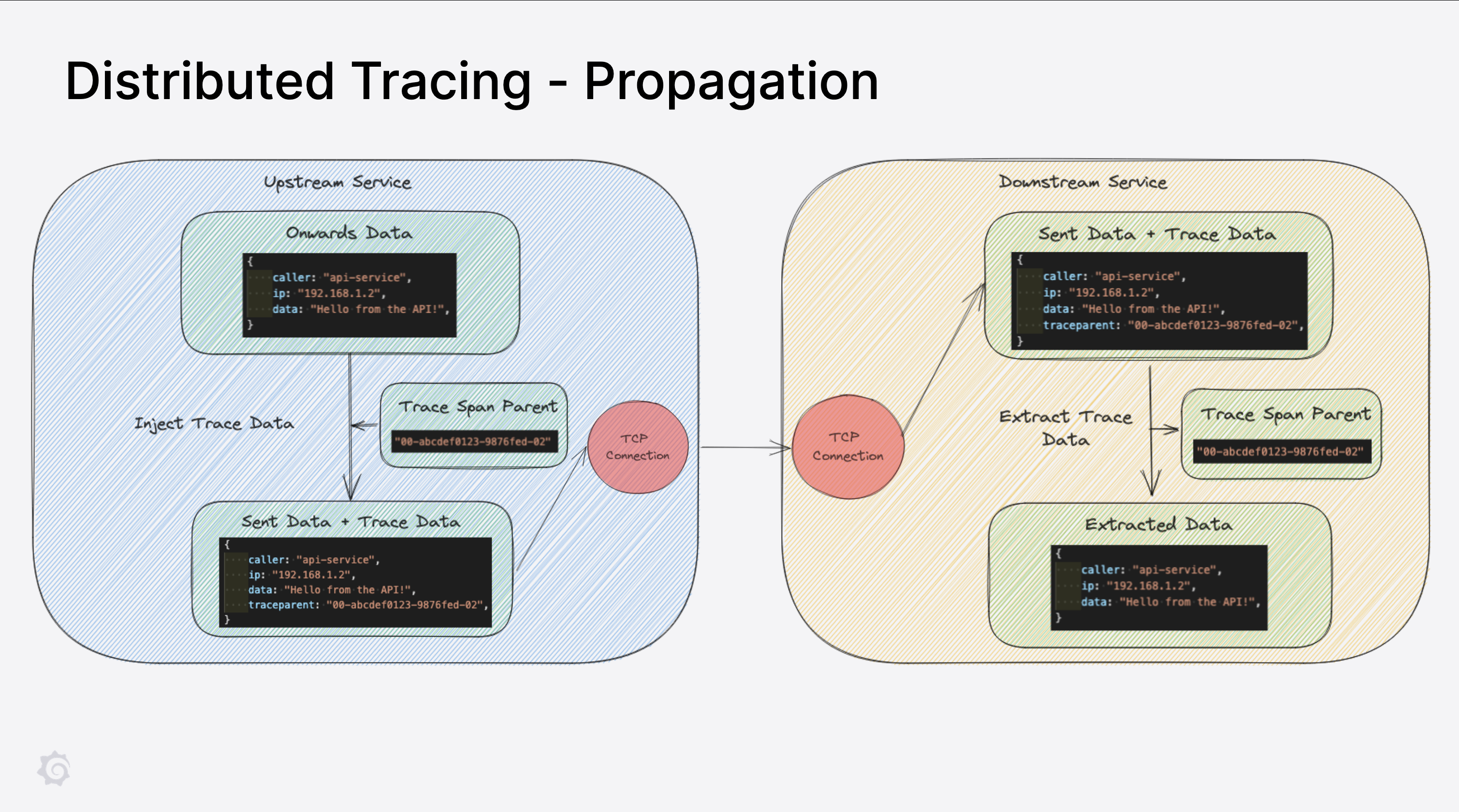

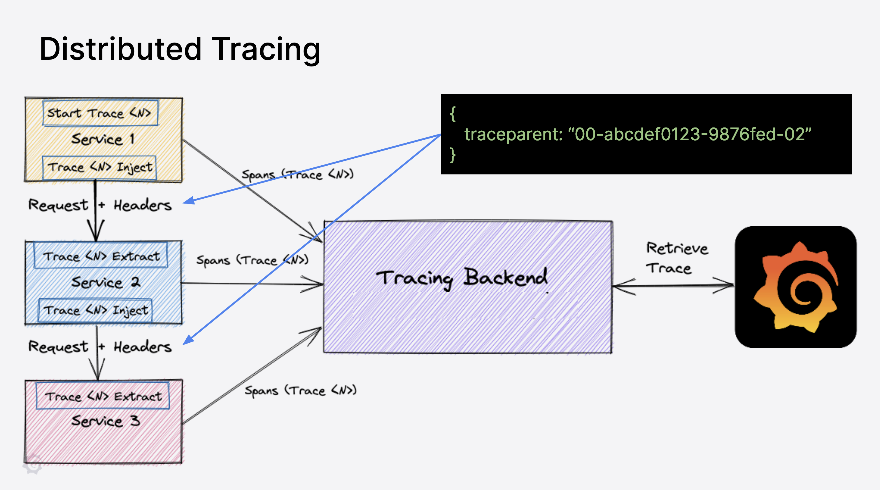

Propagation
Modern applications are not usually not the monolithic applications of old, where single binaries contained all of the code, and multiple instances of the monoliths were run to ‘scale’ to increased traffic. Modern applications are built using a large number of microservices, each one specifically designed to handle specific portions of a request/data flow.
Traces are (usually) tied to a request/response model, being initiated when a request is received by application and ending when a response is returned. Each request could flow through a number of different services (eg. an API service, a caching service, a processing service, a database service, etc.), and therefore to ensure that the trace includes every service that the data is routed through there needs to be some way of sending the details about a trace with the data that’s sent to each service.
This is called trace propagation, and the actual mechanics of it alter depending on the way that data is passed around services. The majority of services in the modern application world use REST (via HTTP) or protobufs (via gRPC, which is itself handled by HTTP/2). Because a trace is just a metaobject comprised of spans, all that needs to happen to continue a trace from one service to another is the addition of a trace ID and the last current span ID to the data send to a downstream service.
Distributed Trace Propagation
Many instrumentation SDKs, include propagators that can handle a number of different transport protocols, and when matched with appropriate auto-instrumentation mean that an engineer doesn’t even have to consider writing any code to inject the downstream data with the trace information, it gets handled automatically (for example in the case of HTTP, headers are included that specifically deal with trace information that gets extracted by the OpenTelemetry SDK in the downstream service to carry on a trace).
The W3C Trace Context is the default way of sending propagation information in OpenTelemetry SDKs. However, the SDK also allows you to provide custom propagators to it instead, which means that if an application uses a custom protocol or networking scheme, engineers can write propagators and extractors to handle these as well.
